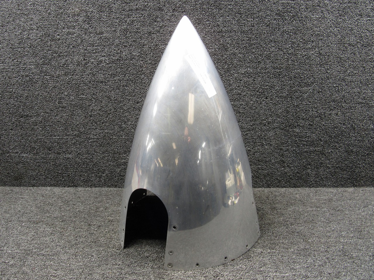

So I bought a fully decked out Miller Syncrowave 250 with running gear, water cooler, torch, dual flowmeter, and a tank of argon and started welding those aluminum prop spinners for 40 bucks each.

Welding in my own garage was way better than moonlighting at a second job and it payed a lot better.
