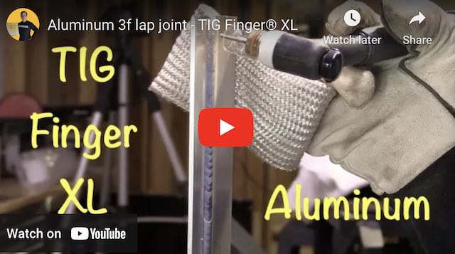

There are several techniques that will work for learning how to tig weld aluminum lap joints.
This first video shows my friend and welderskills.com instructor Brad Goodman pulsing with the foot pedal on a PrimeWeld TIG225x machine with a #5 gas lens
primeweld 225 tig with stuff
Watch the Best "Back to Basics" Video on TIG Welding Aluminum. click here
This video shows a conventional technique using a foot pedal
I used a #8 pro clear cup for filming this video and it really lights up the area and helps me see the weld area better
3f-aluminum-lap-thumb

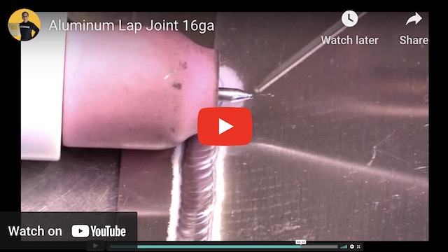

How to TIG weld thin aluminum lap joints
16ga-aluminum-oap-thumb

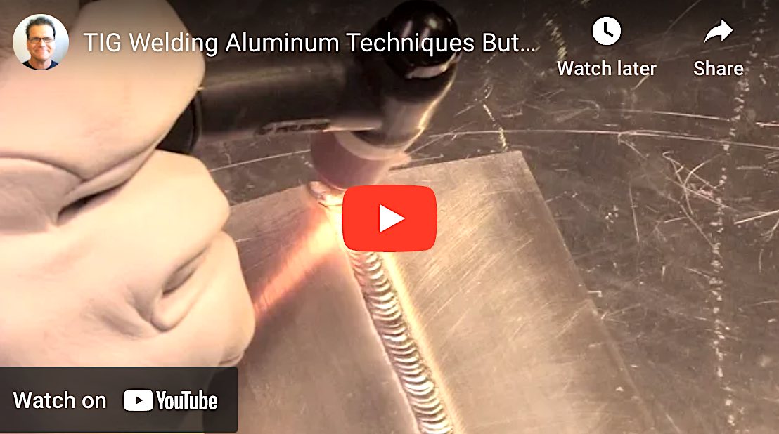

How to TIG weld Aluminum Butt and Tee joints
tig aluminum butt tee yt thumb
