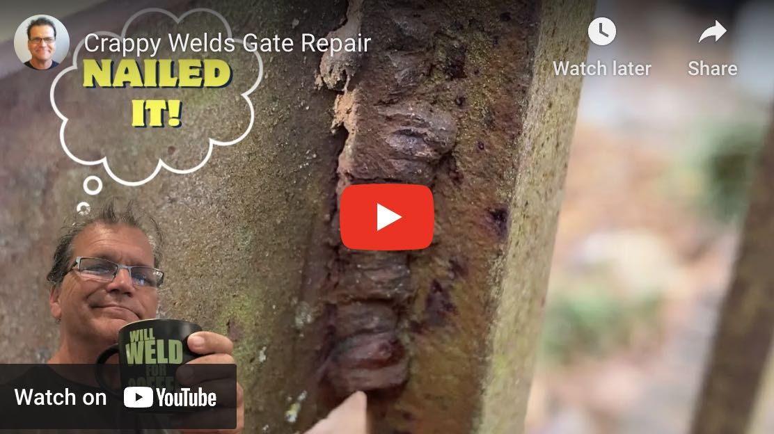

It is also a stick welder ( I repaired a gate using 3/32" 6011 rods off 115 volt power...see video here)
gate-mig180-primeweld-thumb
