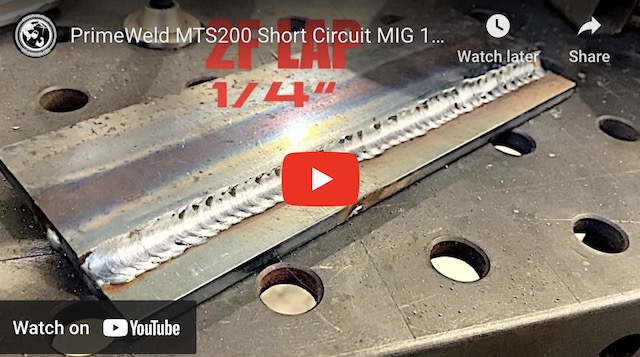

This short and sweet video shows a 1/4" thick lap joint welded in 2F position.
20 volts
310 inches per minute
.035" ER70S-6
C25 GAS 25CFH
