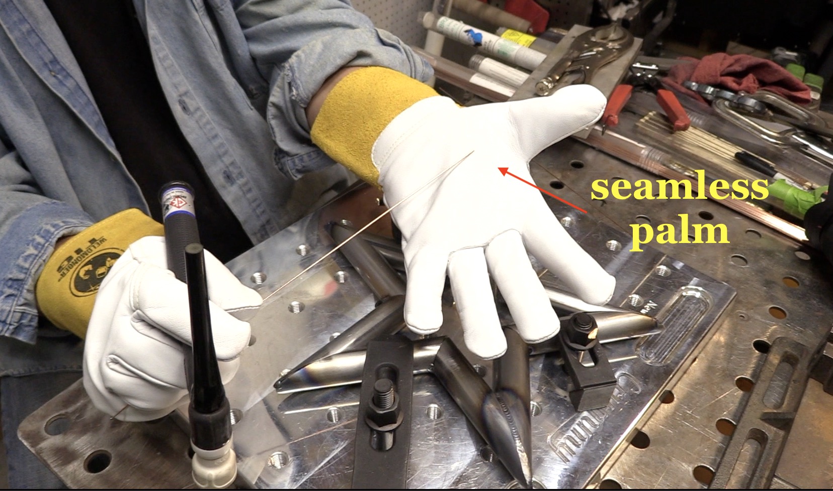

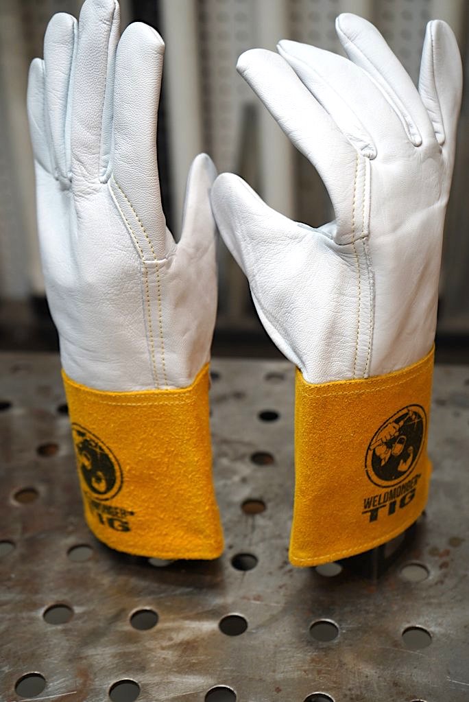

click here to learn more about my new TIG gloves
They are Both Soft and Durable
