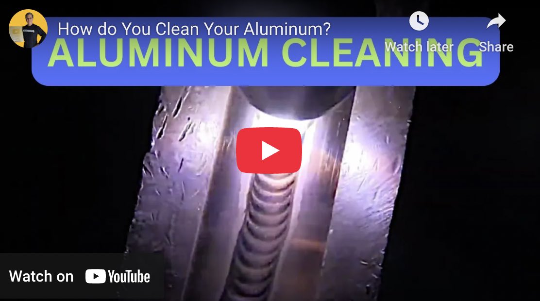

 Surface Prep Tips for TIG Welding Aluminum
CLEANING-ALUMINUM-THUMB
They say the 3 C’s of Tig welding aluminum are:
  1. CLEAN
  2. CLEAN
  3. CLEAN
but are there exceptions to this?  keep reading
ALL ALUMINUM  naturally forms an oxide layer (aluminum oxide) that melts at over 3,700°F—while the base metal melts around 1,200°F.
That is why aluminum is typically welded using Alternating current (AC).
The reverse (electrode positive) portion of the AC cycle provides a cleaning action that is beneficial in breaking up the aluminum oxide layer that is on the surface all aluminum:
But that doesn’t mean that all aluminum needs stringent cleaning before TIG welding.
What?
That probably goes against what all text books recommend but it is just reality.
I am NOT saying that ALL aluminum can be welded with ZERO cleaning.
But Not all aluminum requires wire brushing or abrasive cleaning before welding.
In fact, you would most likely get fired at a lot of manufacturing facilities if you put wire brush marks on aluminum parts.
There is a big difference between brand new aluminum tubing, and an aluminum handrail near the ocean.
Brand new aluminum can usually be tig welded with only a simple wipe down to remove shop dust.
That heavily oxidized aluminum handrail that has been exposed to salt air, will almost always need cleaning using wire brushes, wire wheels, or abrasives to remove the heavy layer of oxide.
  • If a heavy oxide layer isn’t removed, you’ll get a dirty weld, along with poor fusion.
Surface prep checklist:
  1. Degrease with acetone or a dedicated aluminum cleaner (no oil-based solvents).
  2. Wire brush with a dedicated stainless steel brush (never use one that’s touched steel).
  3. Don’t overbrush with high RPM wire wheel—you can smear oxide into the surface.
  4. If needed, use debur tool to scrape or use file on edges to expose clean metal right before welding…especially on plasma cut edges.
Also, weld as soon as possible after cleaning to prevent fresh oxide or moisture from forming.

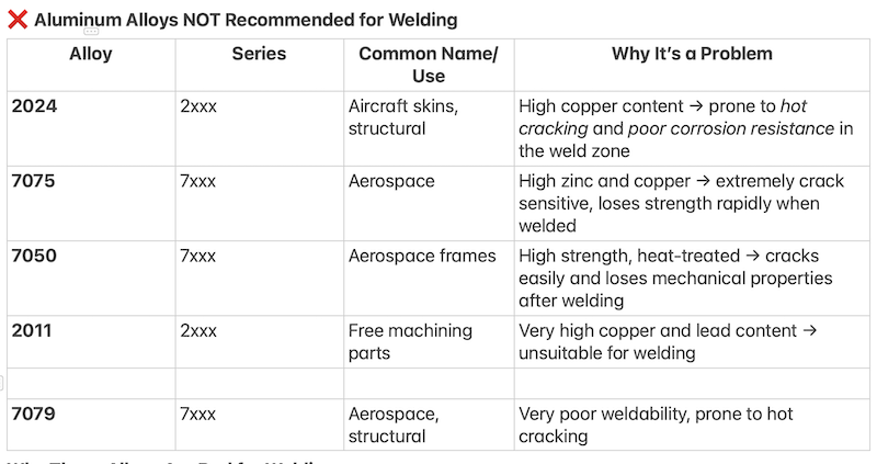

🚫 Which Aluminum Alloys Should NOT Be Welded?
Not all aluminums are weldable—even if they look the same. Some crack very easily when tig or mig welded, especially certain high-strength grades.
2024 and 7075 are the 2 main aluminum alloys not recommended for welding.
Both are heat treated for high strength  and lose much of that strength if welded using arc welding processes like tig or mig.
aluminum-alloys-not-recommended-for-welding-chart
But how do you tell if a part is made from 2024 or 7075?
The first clue is to look for prior welds on the part.
If there are mechanical fasteners like rivets or screws in areas where it would  have been easier to weld it, then it is likely the part is made from either 2024 or 7075.
There are also chemical tests to determine aluminum alloy types but they not readily available and require some training and experience to use effectively.

🔥 What is Hot Shortness?
Hot shortness is when aluminum cracks while it's still partially liquid during cooling. It happens because:
  • Some alloys form low-melting eutectic phases at grain boundaries.
  • These melt too early or too late in the weld cycle and lead to liquation cracking.
This is why certain alloys (like 2024 or 7075) are not recommend for welding—they’re full of elements like copper or zinc that create low melting eutectics.
