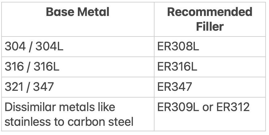

Common Stainless Filler Rod Types
basic-stainless-filler-metal-chart

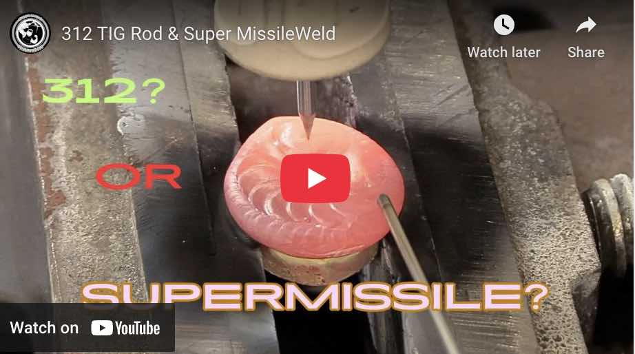

4. ER312 – For Dissimilar metals or Crack sensitive Stainless
312-SUPERMISSILE-THUMB
What it’s for:
ER312 is a high-strength, high-ferrite rod that’s designed to weld dissimilar metals and resist cracking in difficult-to-weld stainless alloys. It's often used for maintenance and repair.
Key Characteristics:
  • High tensile strength (over 125,000 psi).
  • Not alloy-specific—works across many stainless and carbon grades.
  • High ferrite content improves crack resistance under stress or mismatched expansion rates.
Use When:
  • Welding stainless to carbon steel, manganese steel to stainless, and pretty much any steel to any other steel.
  • The base metal is unknown, or difficult to match.
  • Repairing cracked stainless parts or castings.

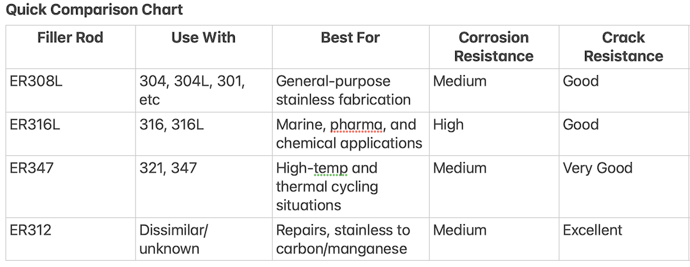

Final Tips for Filler Rod Selection
stainless-tig-rod-comparison-chart
  • Always match the filler to the base material whenever possible.
  • For food-grade or high-corrosion environments, go with ER316L or ER347.
  • For repairs, unknown metals, or difficult welds, ER312 can be a lifesaver.
  • Keep rods clean and dry—stainless filler rods are prone to contamination.
