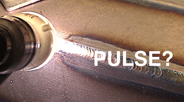

pulse tig joint
scroll down for settings
METAL TYPE = CARBON STEEL
THICKNESS = 11GA
WELD TYPE = Fillet weld
JOINT TYPE = CORNER JOINT
POSITION = 2f  horizontal
AMPERAGE = MACHINE SET TO 142 amps with foot pedal control
FILLER WIRE = 3/32” ER70S6
POLARITY = DCEN
GAS FLOW = 25 CFH argon
CUP SIZE =  12
ADDITIONAL SETTINGS =   2 pulses per second, Background current 30%,
PRE FLOW = .5 SEC
POST FLOW = 7 SEC
TIPS: KEEP A TIGHT ARC
 Aim for an arc length that is equal or less than the diameter of your tungsten electrode.Torch angle can be forgiving provided your arc length is tight.Keep the hot tip of the filler wire shielded by the argon envelope from the tig cup
