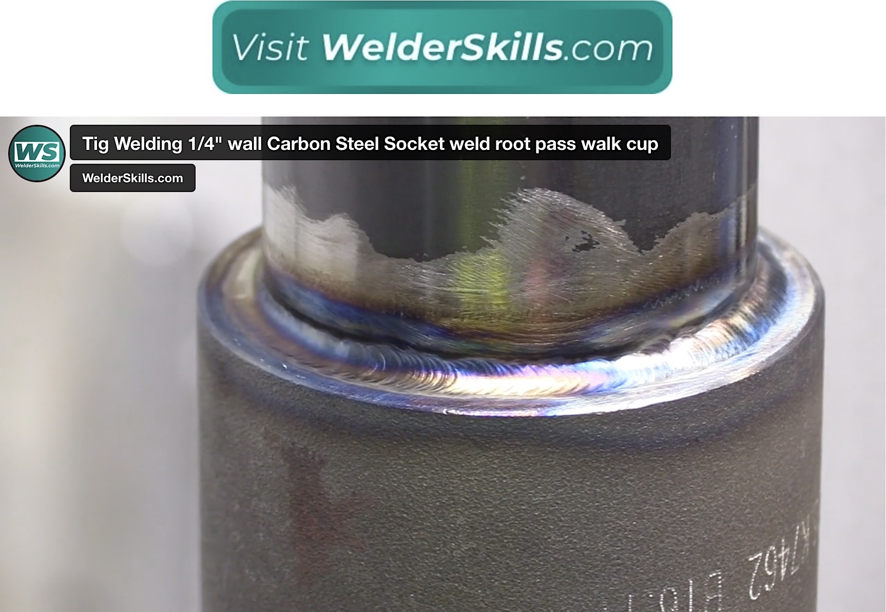

Tig Welding 1/4" wall Carbon Steel Socket weld root pass walk cup
scroll down for settings
METAL TYPE = CARBON STEEL
THICKNESS = WALL THICKNESS 1/4”  2 INCH SCHED 40 PIPE
WELD TYPE = Fillet weld  SOCKET WELD ROOT PASS
JOINT TYPE = SOCKET WELD
POSITION = ROLLED OUT ON TURNTABLE
AMPERAGE = 145 amps
FILLER WIRE = 1/8” ER70S2
POLARITY = DCEN
GAS FLOW = 20CFH argon
CUP SIZE =  7
ADDITIONAL SETTINGS =  PRE FLOW = .5 SECPOST FLOW = 11 SEC
TIPS: KEEP A TIGHT ARC
 Aim for an arc length that is equal or less than the diameter of your tungsten electrode.Torch angle can be forgiving provided your arc length is tight.Keep the hot tip of the filler wire shielded by the argon envelope from the tig cup Same settings work with free hand as well as walking the cup techniques.
