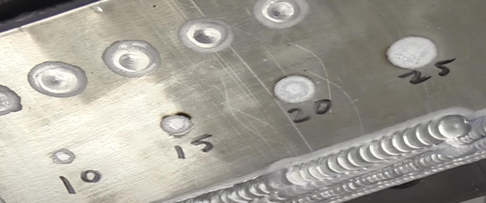

Let's take gas flow rate for example.
A difference of 5 cfh on carbon steel will usually not be detectable as far as any difference in the puddle goes.
But on aluminum, 5cfh difference in argon flow rate can make a big difference. The reason is that the cleaning action of the AC arc will only work where there is argon shielding.  So simply  increasing the flow rate can increase the cleaning zone.
flow-rates-cleaning-path
In the video at the top of this page, I used a #7 clear cup and normally, you would think 20cfh would be about right and actually, would have worked pretty well.
But a simple down and dirty test using slightly different flow rates showed me that bumping up to 25cfh worked better than 20cfh and provided a brighter cleaner puddle.
