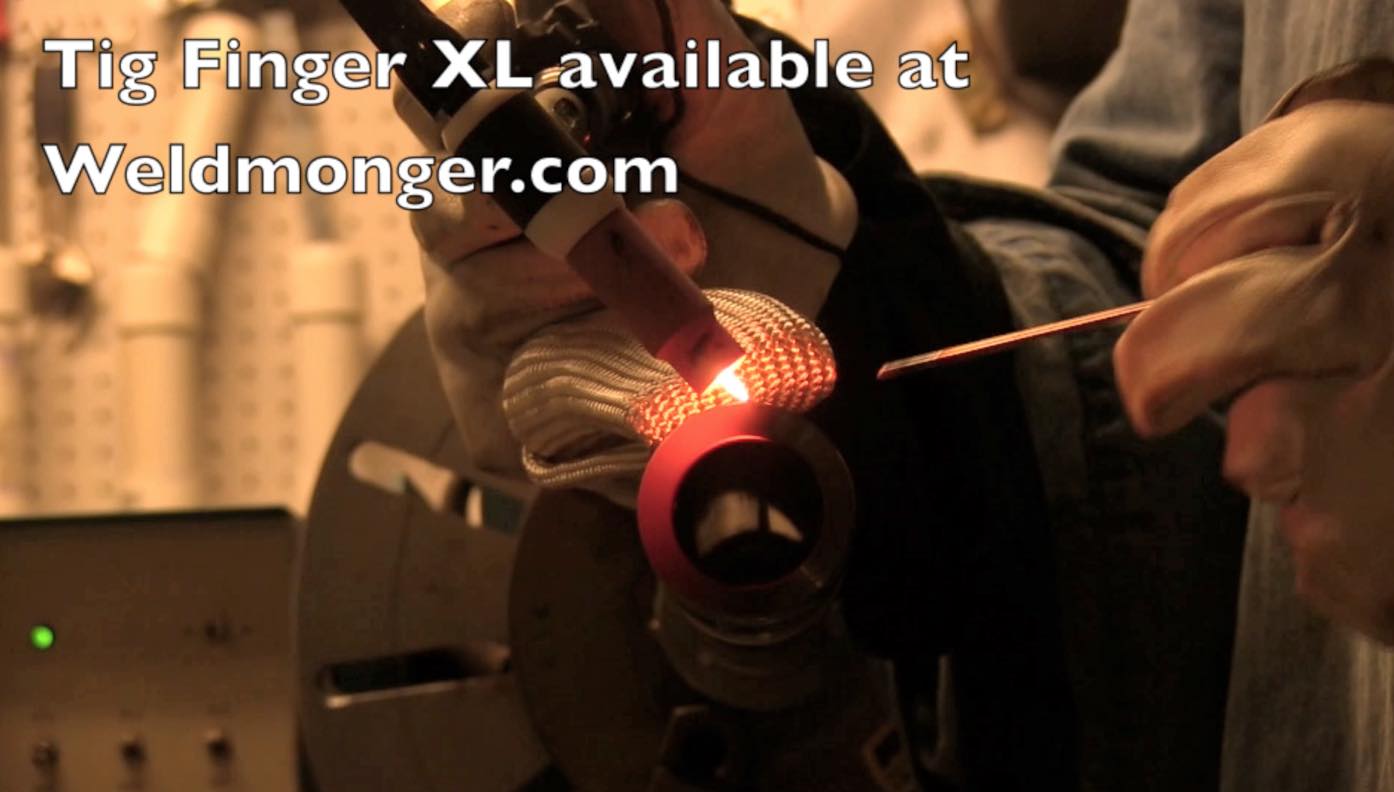

I welded the first run of parts somewhere at around 180 amps and using 1 to 2 pulses per second just propping my finger on the part using a TIG finger XL...
And on the other end that had a flange, I walked the cup using a number 6 cup using about 15 to 20 CFH of argon flow.

Then I set up my welding lathe.  (a welding lathe typically has a turntable, a torch holder, and tailstock...I got mine used off ebay)...
It has a turntable with the three jaw chuck a tail stock that is air operated and an air operated torch holder too.
It takes a few minutes to set up and get dialed in but man is it worth it for a job like this.
My final optimum settings using the Everlast 210ext were 210 A 50% pulse on time 40% background.  for the end without the flange.
And for some of the flange welds I just walked the cup at around 180 A using at 3/32 rod...for others I used the torch holder and used 210 amps with 2 pulses per second and both pulse and background set to 60%.

These parts got really hot with 8 total welds so using a TIG Finger XL really helped to give me a place to prop as I rotated the torch to keep the angle good.
