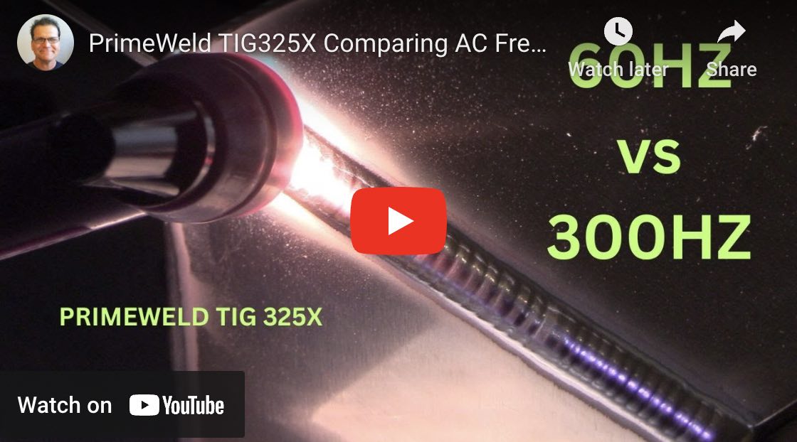

How do I set AC frequency for TIG welding aluminum?
primeweld325-ac-freq60-300-yt-thumb
There are always exceptions but as a rule of thumb, I like to use lower frequency settings for thick aluminum and higher frequency settings for thinner aluminum.

AC balace and AC frequency are 2 settings that are pretty much standard equipment on modern TIG welders
This video gives some practical examples of how to set AC frequency for different situations.
Higher AC frequency settings focus the arc and a frequency of 100-120hz is a great all around setting.
Higher frequency settings are very useful for pinpointing the arc but are only effective if you have adequate amperage to take full advantage.
You will typically need more amperage to achieve the same heat input at a lower ac frequency setting.
If you have a 200 amp tig welder and find yourself needing to weld 1/4" thick aluminum, you might need to use a low frequency setting of 50-60hz in order to make things work.
