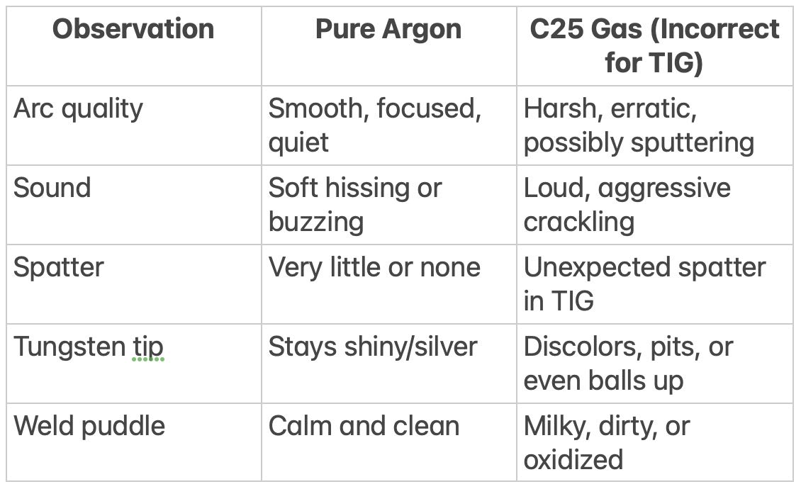

What to do if you think you have a bad tank of argon
Cylinder mislabeling can happen, and using C25 instead of pure argon can ruin a TIG weld. Here are some quick easy ways to tell if a mislabeled "argon" cylinder is actually C25 (75% argon / 25% CO₂):
✅ 1. Watch the Arc Behavior
If you suspect the gas is not pure argon, do a quick TIG arc test:
mig-gas-tig-gas-troubleshooting
👉 If it acts like MIG, not TIG, it’s probably C25.
🔥 2. TIG Torch Test with No Filler
  • Set up a DCEN TIG weld on clean carbon steel.
  • Strike an arc and hold a puddle for a few seconds with no filler.
  • Look for:
  • Smooth, shiny puddle → ✅ likely pure argon.
  • Aggressive puddle, rapid oxidation, blackened edges → ❌ likely C25.
🧪 3. Look at the Weld Surface After Cooling
  • Pure argon: the weld and heat-affected zone should stay shiny or lightly straw-colored.
  • C25: surface turns gray, black, or sooty—clear sign of CO₂ contamination.
