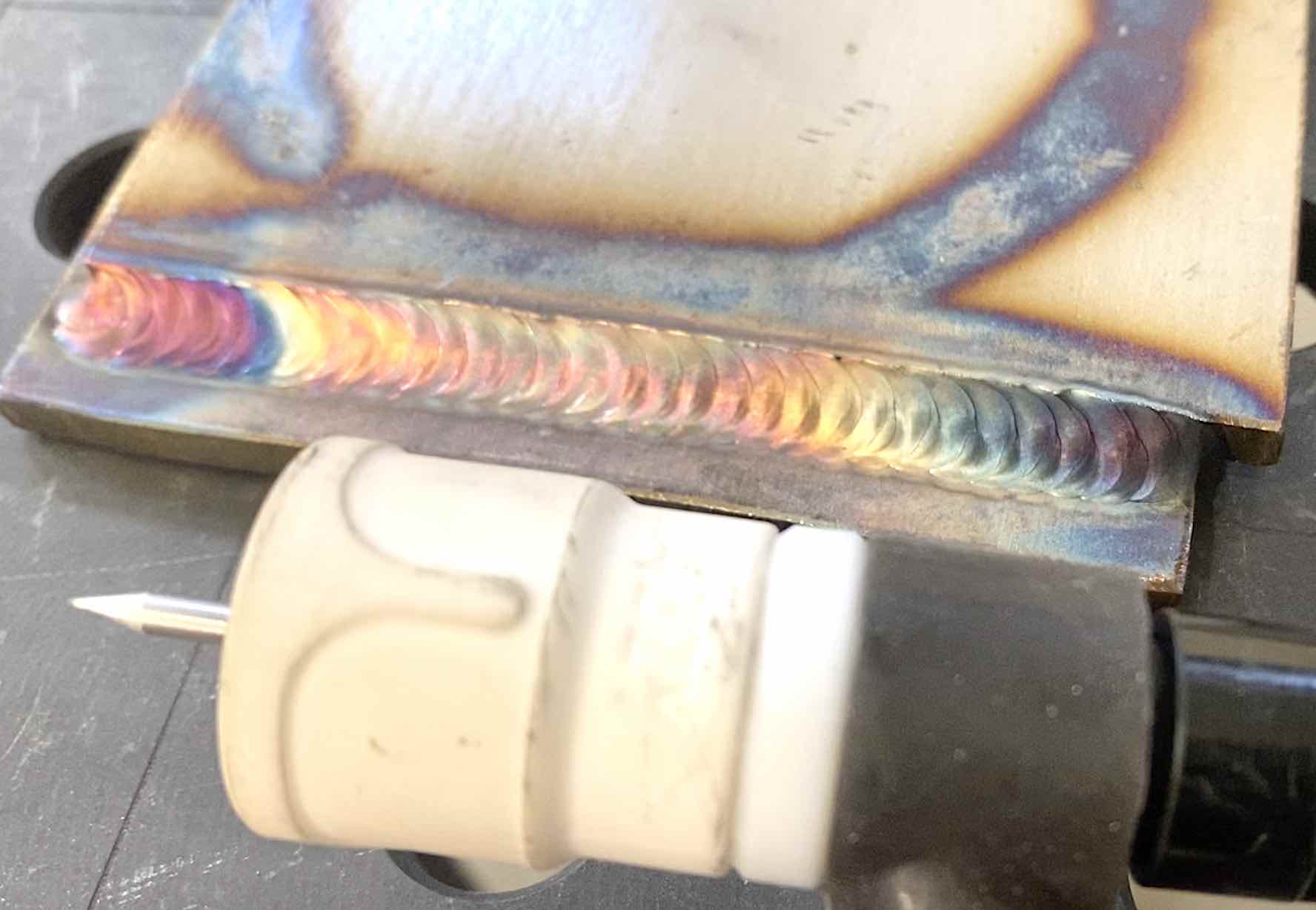

TIG welding Stainless Lap joint  1/4" 304L
I found a few pieces of laser cut 1/4" thick 304L stainless in one of my scrap buckets so I am using it for a lap joint video.
Stainless steel requires less amperage than carbon steels so even for 1/4" thickness, I only used 95-105 amps.
In fact, I was plugged in to a 115volt circuit for this video.
TIG welding stainless lap joint

Different cups are needed for different applications but overall, I really like the Jazzy 10 ceramic cup.
To me, it seems like a big improvement over even a #8 gas lens cup.
The additional diffusers provide for much better argon shielding with about the same argon flow rate as the #8 uses. (around 20-25cfh)
I used a #7 clear cup for filming on the root pass because clear cups tend to light everything up better and can make for a more instructional video.
The first pass seemed to need around 105 amps to get penetration into the root.
Sometimes 1/4" thick stainless requires a full 1/4" fillet weld size so I decided to make a second pass.
I switched over the the ceramic jazzy10 cup for the second pass at around 95 amps.
