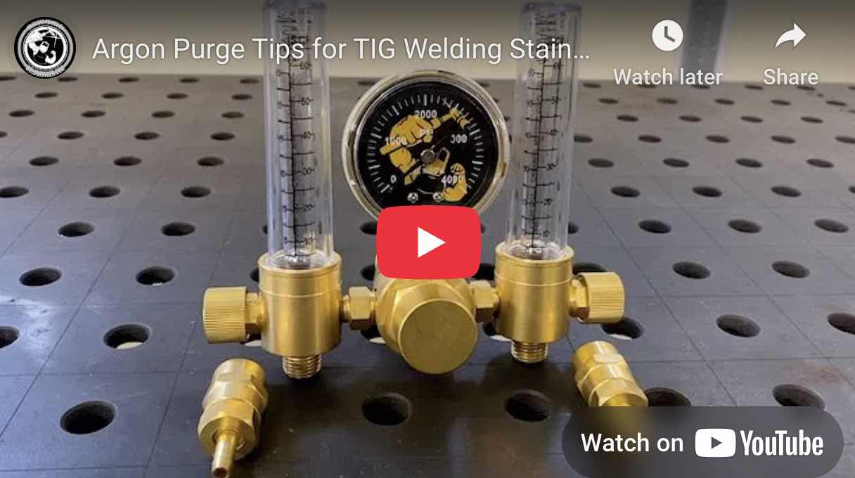

6. Neglecting the Back Side of the Weld
The Mistake: Ignoring backpurging or not protecting the root side leads to sugaring, especially on pipe or sheet welds.  Sugaring is a common term for excessive oxidation or granulation. It is a severe defect that causes weld failures and can contribute to bacteria growth inside a stainless pipe or tube.
How to Avoid It:
  • Backpurge with argon on full-penetration welds.
  • On certain jobs, an argon purge is mandatory. But on less critical sheet metal work, If you can’t purge, use backing bars or copper tooling to shield the back side.
  • Maintain purge flow during and after welding.
