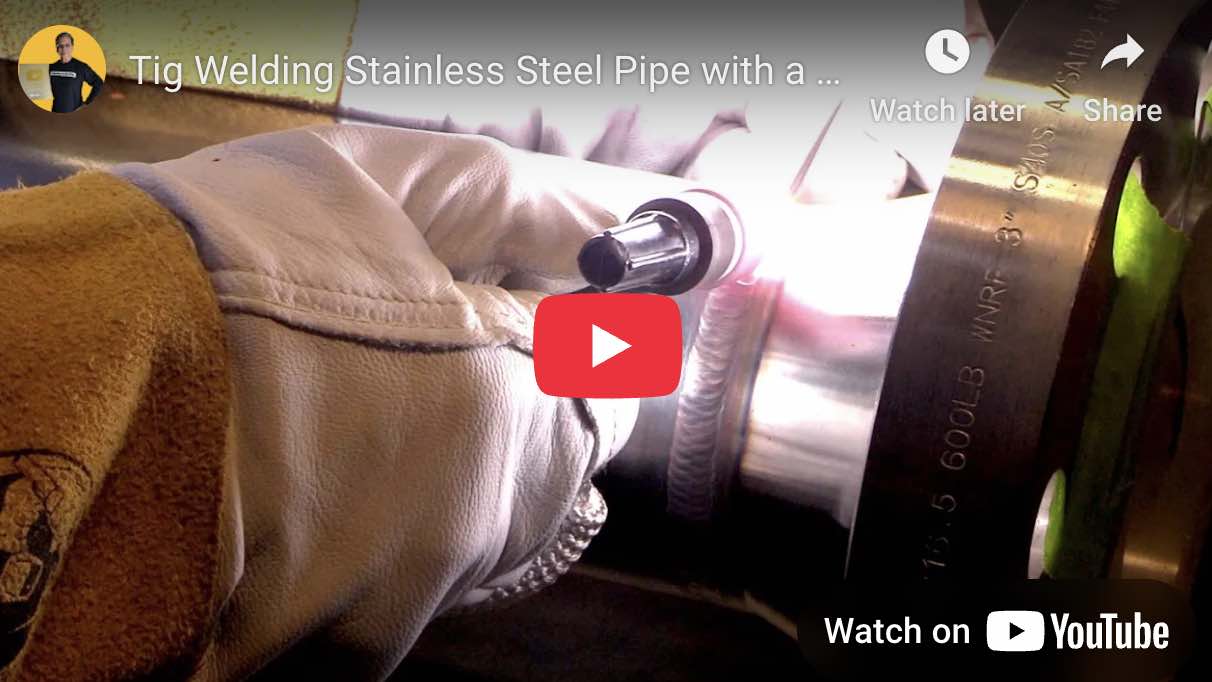

Walking the Cup Video on TIG Welding
walking-the-cup-stainlesspipe-thumb

Root pass techniques
use either a laywire technique with very little sideways movement or a dip keyhole technique.
Key Points:
  • Use a gas lens and a #8–#12 cup for good gas coverage
  • Backpurge with 100% argon to prevent sugaring
  • Use 3/32" or 1/8"  tungsten, ground to a point
  • Torch angle: 10–15° push angle
  • Travel steady and maintain tight arc length
