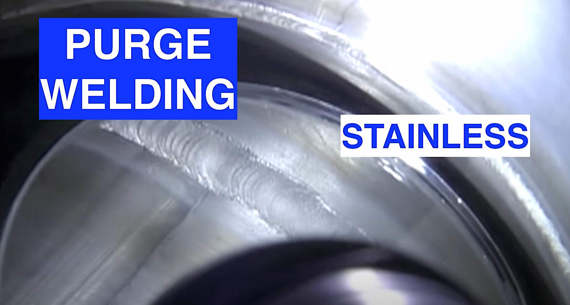

This video shows the difference between bridge tacks and penetrated tacks along with purging and root pass techniques with clear arc shots and settings.
I get a lot a questions about the tape I used for purging and it is high temp tape for powder coating and works great for purging stainless pipe so that you can see thru and inspect tack welds and root penetration.
Stainless steel requires argon shielding for the penetration side of open roots and one of the best ways to get purge gas is with a dual flowmeter.
A dual flowmeter lets you get a purge without 2 argon cylinders and that can be a pretty big deal if you are toting them up stairs or from the truck into the job site.

Another type of tig welding stainless pipe is sanitary tubing.
Sanitary tubing is used for breweries, hemp processing, food and beverage, and pharmaceutical applications.
With sanitary stainless welding, the quality of the inside of the root pass is the main thing.
It must be silver and free from an crevices that might trap bacteria.
Getting a perfect purge is the way to get that high quality penetration that wont trap bacteria.
Sanitary stainless is mostly done without filler metal.
The fancy word for that is autogenous welding.
