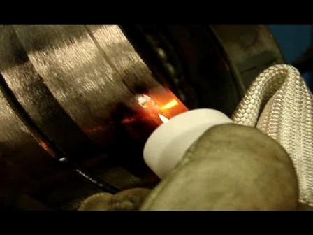

What do tig welding techniques for lap joints have in common with the techniques used for butt joints?
Almost the same exact technique works on both laps and butts.
Forward and back , forward and back…
Or
Forward and pause , forward and pause…
I like to move the arc in a dead straight line on sheet metal no matter what. It does not make any sense to me to move the torch sideways if you are welding sheet metal because it just slows your travel speed down and spreads the heat where it doesn’t do any good.
If you watch the video closely, you will notice that there is not a whole lotta difference in my tig welding techniques for lap joints vs my technique for butt joints… Maybe some subtle differences but mostly just the same thing going on.
And you know what? The same technique works for other metals like stainless steel, aluminum, 4130 chromoly, titanium, inconel, magnesium, hastelloy...you name it.
Watching the video, it looks almost like pulse welding because the rod chills the puddle momentarily when the rod is dipped, and then you move ahead with a tight arc penetrating into the root of the joint. Then you move backward and bit and lengthen the arc while you add the rod. This technique does vary the voltage somewhat...the voltage increases when the arc length increases but when you tighten the arc moving forward the heat is pinpointed into the root.
I find this technique especially helpful for thin gauge tee joints.
Thin gauge tee joints are always a balancing act between getting enough heat to penetrate into the corner, and using too much heat causing the back side to be all melted back….and ugly.
Using the forward and back tig welding technique lets you move the puddle with technique instead of just using more amperage. It lets you move the puddle forward and then to get back over the weld puddle while you add the rod….gives you more time to add the rod without hanging out over the thin sheet metal.

Here are the tig welder settings used to make the lap joint and butt joint welds in the video.
• polarity = DCEN
• 100-125 amps using a foot pedal to vary amperage
• 2% lanthanated or thoriated electrode 3/32”
• #7 cup with 15-20 cfh flow of argon (in this video an oversized cup was used to allow the camera a better angle to capture the arc and puddle)
