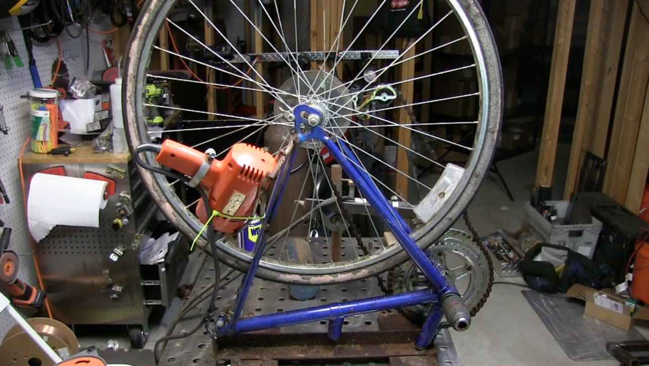

I cut an old 12 speed bike in half and used the back end.
I had a shaft machined that would replace the pedal shaft and had threads turned on it to accept a simple drill chuck.
Because the parts were very small and light, I decided to make this DIY welding lathe specifically for the job and 3/8" drill chucks were plenty heavy duty to hold the parts.
I used a few pieces of 1/4" round bar to fashion a cradle for a Kmart 3/8" variable speed drill motor that I picked up at a yard sale for 5 bucks.
I chucked up a 1/4" piece of round stock in the drill motor and adjusted the cradle so that the round stock would drive the rubber tire.
In 12th gear, there was enough gear reduction to slowly turn the 2" parts...the 1/4" round stock would spin just the right speed and I could get it dialed in just right using a hose clamp on the trigger.
I made a tail stock that was the same height as the center line of the drill chuck and I used a 1/4" piece of stainless tubing to attach a purge hose.
The torch holder was made from an old counter weight and I rigged up some simple adjustments on it so that I could easily position it.
The parts I welded did not require filler metal so I could actually do other things once I got the weld started.
I also hooked up a timer switch to replace the foot pedal and timed the weld so that it would make one revolution plus around 1/4" and then the switch would activate the crater fill function on my miller syncrowave 250.

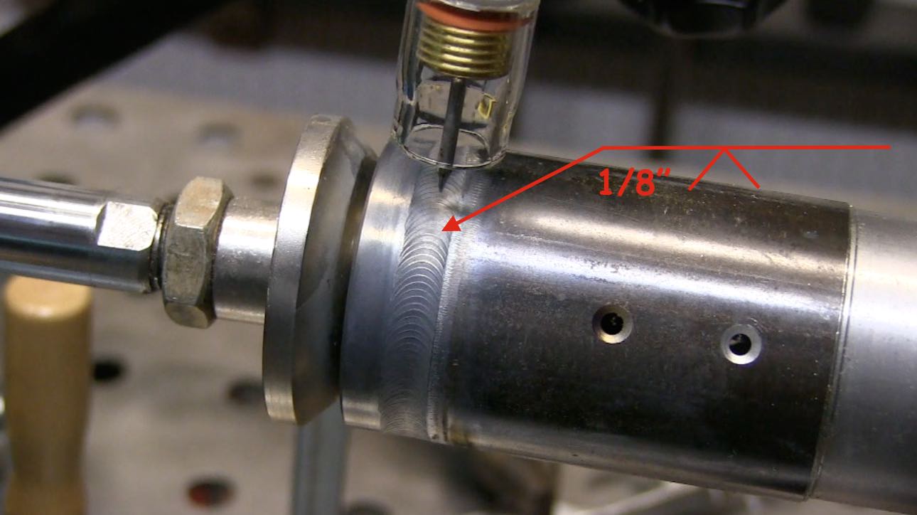

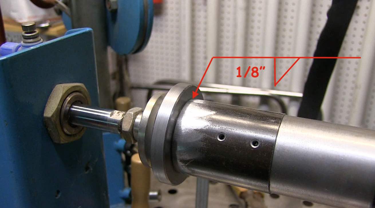

here are some pics on what the weld symbols would look like
This first pic is a partial penetration groove weld. The 1/8" dimension indicates depth of prep.  if it were in parenthesis, it would indicate penetration.
The pic below has a simple fillet weld symbol requiring a 1/8" size fillet weld done from the arrow side. the arrow side is always on the bottom side of the reference line.
