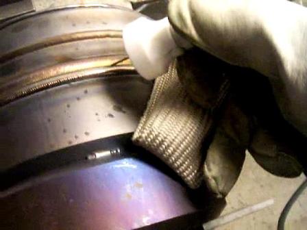

How to Price Welding jobs
Lets talk for a minute on how to price tig welding jobs.
While I was shooting this video, I had to finish a welding job for a machine shop and so I thought it would be interesting to talk about how to price welding jobs.
I have done quite a bit of work for machine shops and here is how I quote jobs...
Since the machine shop fronts the money for materials, I don't have much risk, but I still don't like bidding a job too low and working for peanuts.
Here is my highly scientific formula for pricing tig welding jobs.
Are you ready??
x amount per inch and x amount per tack weld.
play it out and adjust accordingly.
you might settle at a dollar, or 2 dollars, or 75 cents.
but if you put some thought into it, you will arrive at a formula that works for you.
simple.
