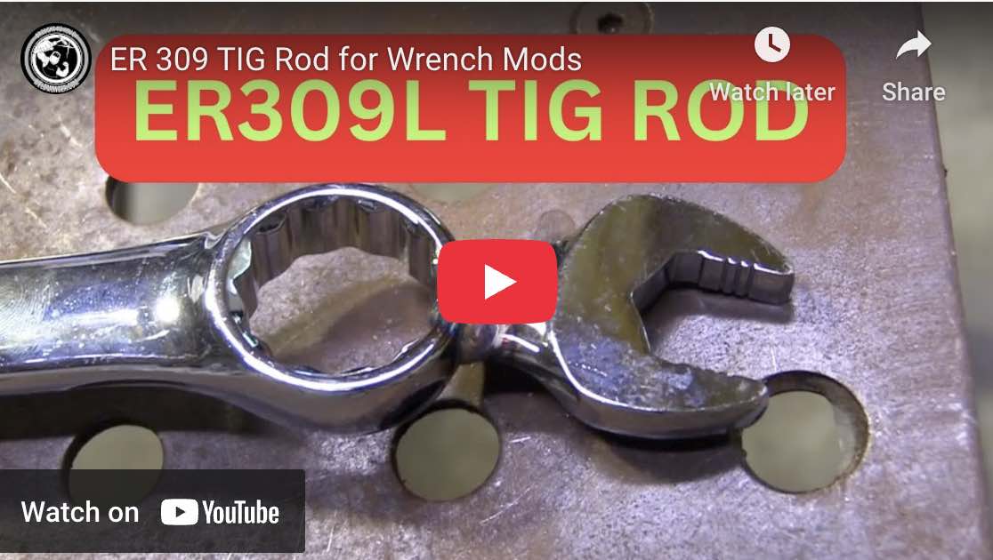

  • ER309L – The most common filler for dissimilar welding. It has a higher alloy content that tolerates mixing with mild steel.
  • ER309MoL – Same as above but with molybdenum for better corrosion resistance, often used in more aggressive environments.
  • ER312 - is similar to a rod labeled "supermissile weld" and is very crack resistant
Avoid using carbon steel or standard stainless (like ER308L) fillers—they won’t handle the dilution as well and can lead to cracking.
ER309L filler rod has been used for decades to weld carbon steel to stainless steel in power plants, paper mills, refineries, and job shops.
