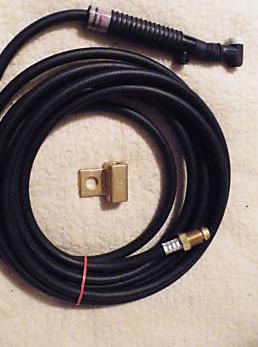

air cooled tig torch 26fv
And the torch cable is often really stiff and seems to wrestle against you.
air cooled tig torch 26v
A smaller tig torch just feels better in your hand and is more nimble and maneuverable.

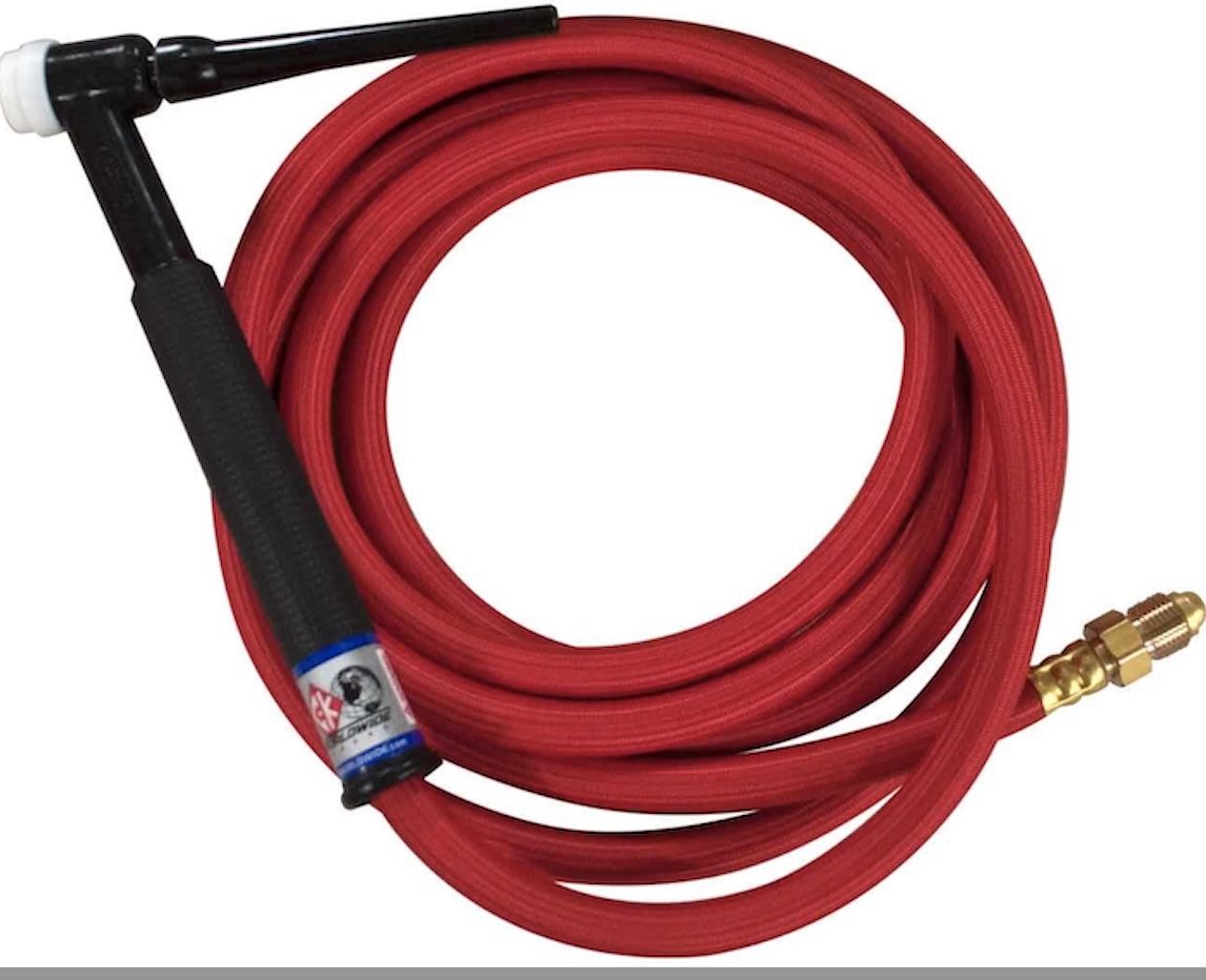

So this is where the CK trim line 200 amp tig torches shine.
A CK trimline 210 air cooled torch and the trim line 26 are much smaller than most 200 amp torches but can still handle welding at 200 amps for long periods without overheating.
They feel good in your hand, and are much more nimble and maneuverable than most other air cooled tig torches that are rated for 200 amps.
 The CK Super Flex cables are the key
