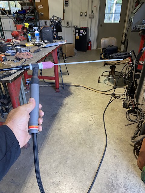

If you are on a job site without your stick stinger... and need to make a quick stick weld on a bracket, you can chuck up a 3/32" 7018 or 6011 in the TIG torch....
stick rod in tig torch andrew
...quick story about how I first learned about stick welding with a tig torch.
Back when I worked for a major Airline Techops division, on a few occasions, my job was mobile welding. Mostly on aircraft, but sometimes shop equipment as well.
One particular day, I was called to weld a piece of galvanized floor grate that had come loose in the cleaning shop and it was a trip hazard.
The Miller syncrowave mobile rig was out on another job, so the only mobile rig was a little Miller maxstar 90 DC inverter.
But it didn't have a stick stinger on it.
My supervisor told me to grab a 3/32" 6011 and chuck it up in a 3/32" collet body.
What??  I thought that was a genius hack.
So I got a forklift driver to park over the floor grate to hold it down while I made a few short welds with the 6011.  Took me about 5 minutes.
And I never forgot that hack.  I wouldn't make a habit out of doing this  because a stick stinger is more durable, but it was good to know that I could burn a stick rod or 2 if I forgot my stinger at home.
