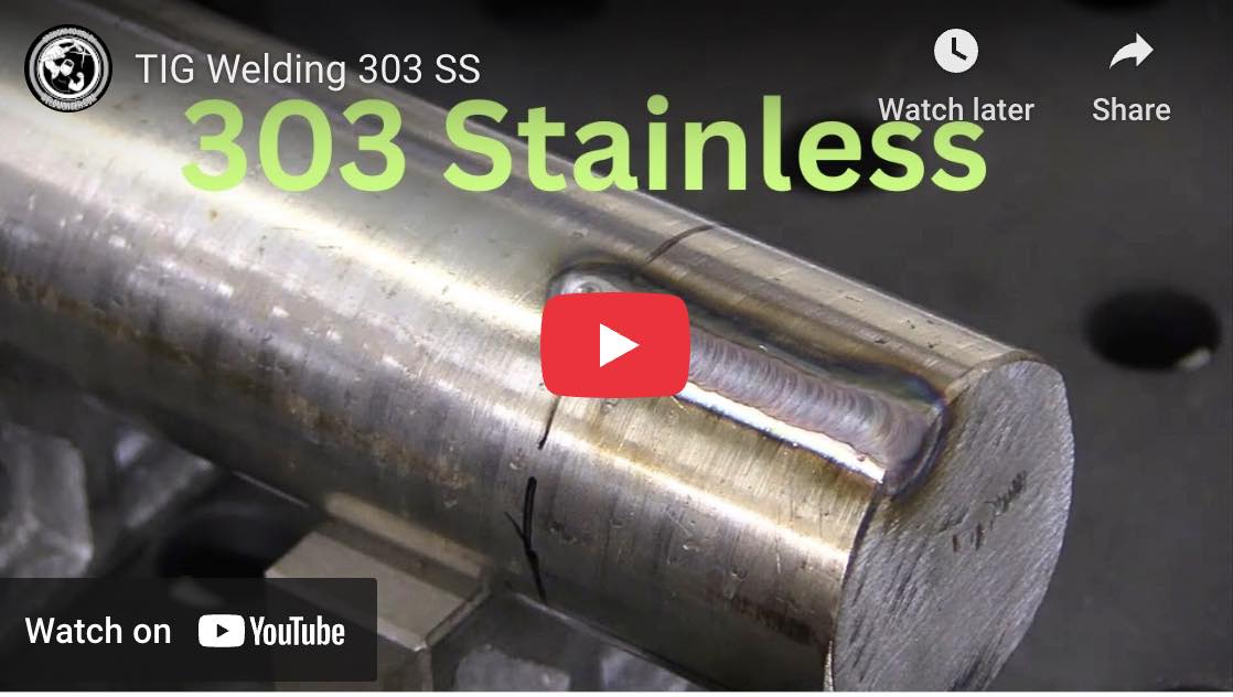

Check out this old video on TIG welding 303 stainless parts...It still holds up with sound fundamentals
Welding 303 Free-Machining Stainless Steel: Recommended TIG Procedures, Filler Metals, and Precautions

ER308L Filler Metal
The most commonly used filler for 303 is ER308L—the low-carbon version designed to match 304 stainless. It works adequately, though it won’t completely eliminate cracking risks.
Both ER309L and ER312 are Alternatives and ER312 has very high crack resistance
ER309L and ER312 have a higher alloy content, making them  more crack-resistant and suitable when welding dissimilar metals or questionable base materials like 303.

Welding 303 stainless steel is far from ideal—but not entirely impossible. In low-stress, non-critical applications, careful TIG welding using ER308L, ER309L, or ER312 filler, low heat input, and excellent shielding can produce acceptable results for non critical applications. Still, welding should be considered a last resort. When possible, choose better-suited alloys like 304L or 316L, or opt for mechanical joining to ensure safer and more durable outcomes.
