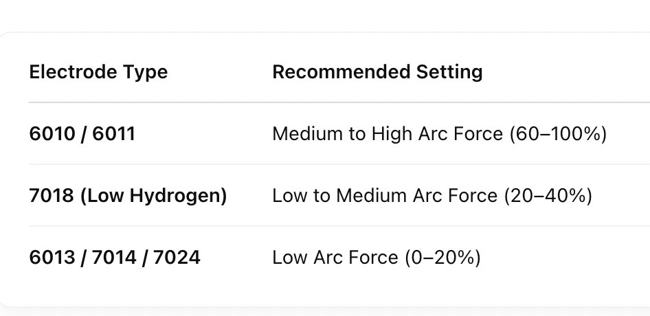

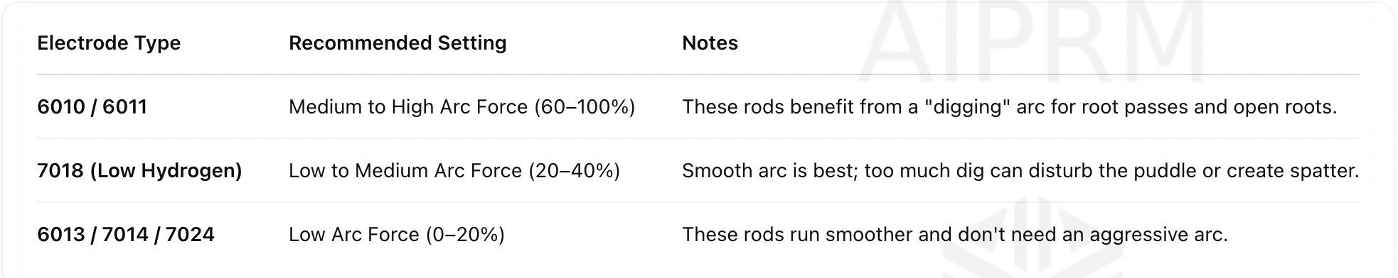

  • Low Setting (0–20%): Soft arc, minimal digging. Good for thin metal or when a smooth bead is desired.
  • Mid Setting (30–60%): Balanced arc. Great for most 7018 applications and general work.
  • High Setting (70–100%): Aggressive arc for deep penetration, roots, and gap bridging. Best with 6010 or 6011.
How to Adjust arc control:
 Start low and increase gradually until you get the arc performance you want.
✅ Pro Tips:
  • On root passes with open gaps, increasing arc force helps keep the arc lit when you’re riding the keyhole.
  • On fill or cap passes, too much arc force can make the arc harsh and unstable.
  • It’s not a one-size-fits-all—tune it based on rod type, position, and base metal thickness.
