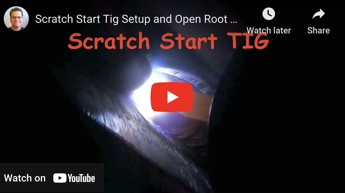

For Certain jobs, the best way to tig weld is still Scratch Start TIG
scratch-start-setup-thumb
The great thing about scratch start tig is that all you need is a DC stick welder, argon, flowmeter, a 105z57 power cable adapter, and an air cooled tig torch with a valve.
See this full article and video on scratch start tig and how to tig with a stick welder
Scratch start TIG is still used quite a bit on for pipe welding and a few other types of jobs where portability and simplicity are important.
