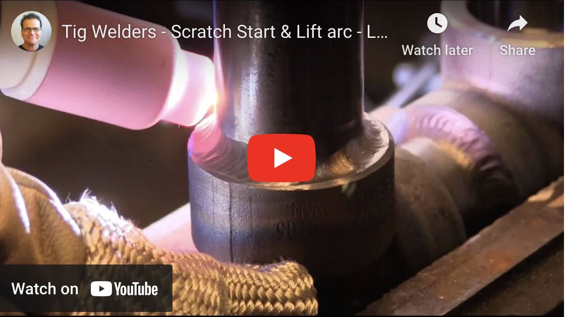

If you already have a DC stick welder like the one shown in the video above, All you need is a cylinder of argon, a flowmeter, and a tig torch with a valve...and you can do scratch start tig welding.
It used to be that scratch start tig was the cheapest way to get started tig welding.
and it still can be provided you already own a DC stick welder.

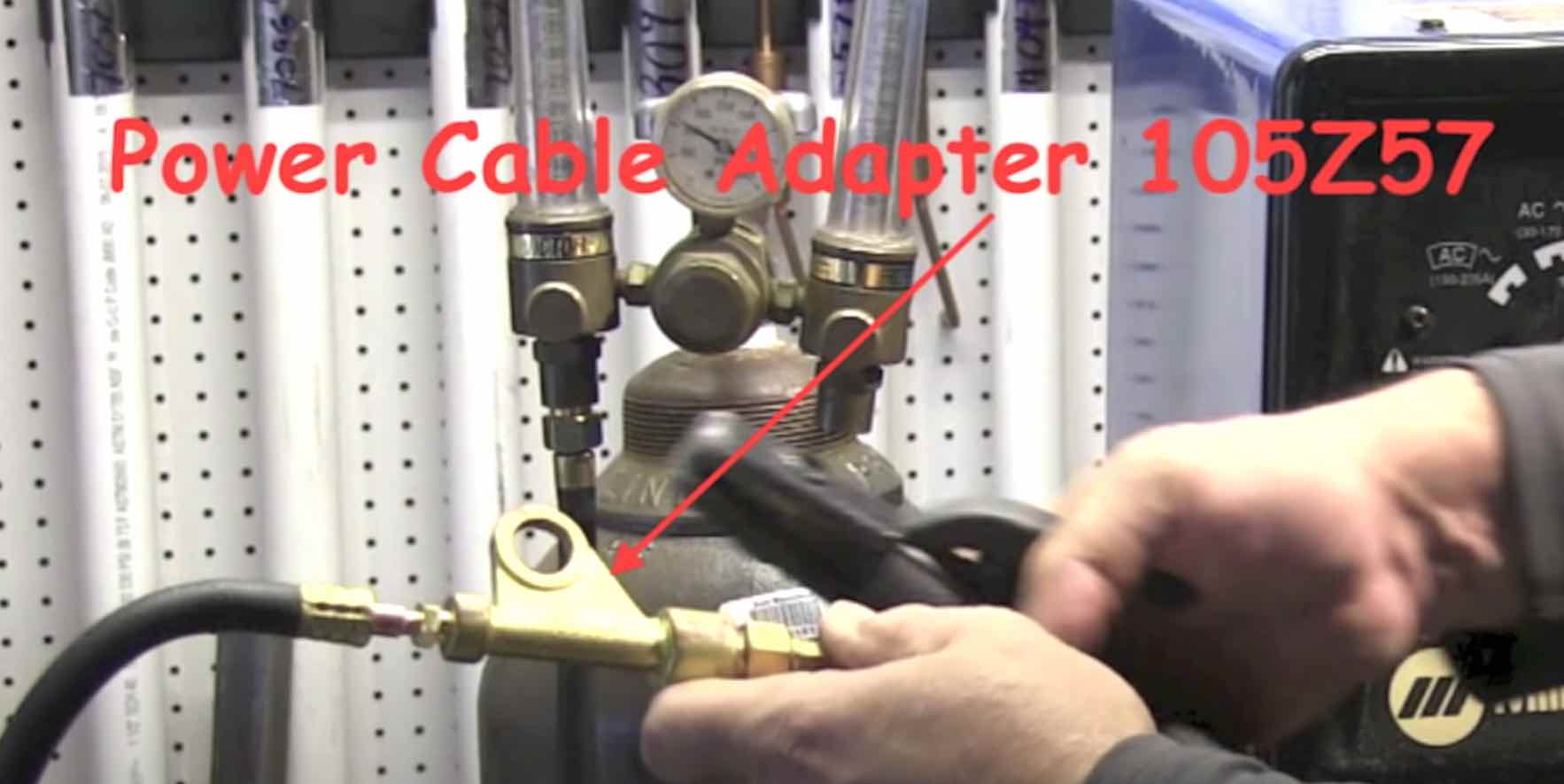

Almost any Stick Welder can be Turned into a Scratch Start TIG Welder
scratch-start-lift-arc-socket-210mp-thumb
Part # 105z57 is what you need along witha single hose air cooled tig torch with valve
power-cable-adapter-105z57-scratch-start
Scratch Start TIG is still used quite a lot for pipe welding because it is so portable.
As long as you have enough welding lead and argon hose, you can be welding 100 feet or more from your welding machine.
Scratch start is almost always strictly a DC tig process because you have to touch the tungsten to the metal in order to start the arc and that just doesn't work out well for tig welding aluminum.
