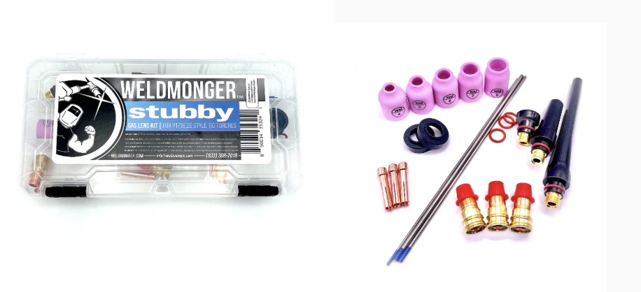

That is where a Stubby Gas lens kit helps
stubby-2-0-kit-label-and-contents-side-by-side
What is a stubby gas lens?
The standard collet body for a 17 air cooled tig torch is almost 2 inches long and uses port holes to push the argon shielding gas  thru the cup.
A gas lens uses  fine screens to diffuse the argon gas to provide a smoother flow.  kinda like the diffuser screen in a water faucet.
A smoother column of argon allows for a longer tungsten stick out.  A long stickout is not always needed but it is great to have the option for hard to reach welds.
A stubby gas lens will allow using the shorter cups that also fit the smaller 9 and 20 style tig torches.
Our Stubby gas lens kit just got upgraded with more cups along with a 3/32" furick stubby gas lens.
That one simple change lets you use furick cups both clear and ceramic without needing to purchase an adapter kit...saving you around 25 bucks should you want to try out some furick cups down the line.
