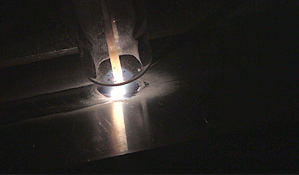

Watching and Reading the Aluminum Weld puddle
full pen clear cup butt
I remember way back to when I was in welding school, my instructor was always telling me to “watch the puddle”.
That was very good advice even if he didn’t explain what I was supposed to be watching.
I figured some things out but I am still learning
Watching the puddle is one of the main things that tells you whether you are getting full penetration on aluminum butt joints.
What I mean by that is that you want to see the puddle sink a bit in between dabs of filler metal in order to know you are getting full penetration.
This can be subtle but the more your eyes get trained, the more readily you can read the puddle.

Amperage is one of the main things that makes a big difference and the amperage needed for achieving a full penetration on aluminum is usually somewhat more than what is required for carbon steel.
For example, the 1G .063” (1.6mm) butt joint in this video required a peak of 70 amps whereas that same joint in carbon steel in the same fixture would have probably required only 60 amps for full penetration.
Amperage needed is also affected by whatever chill bars or heat sinks are in use.
The same joint in a fixture with copper chill bars might require more amperage than one welded in free state with no chill bars.
