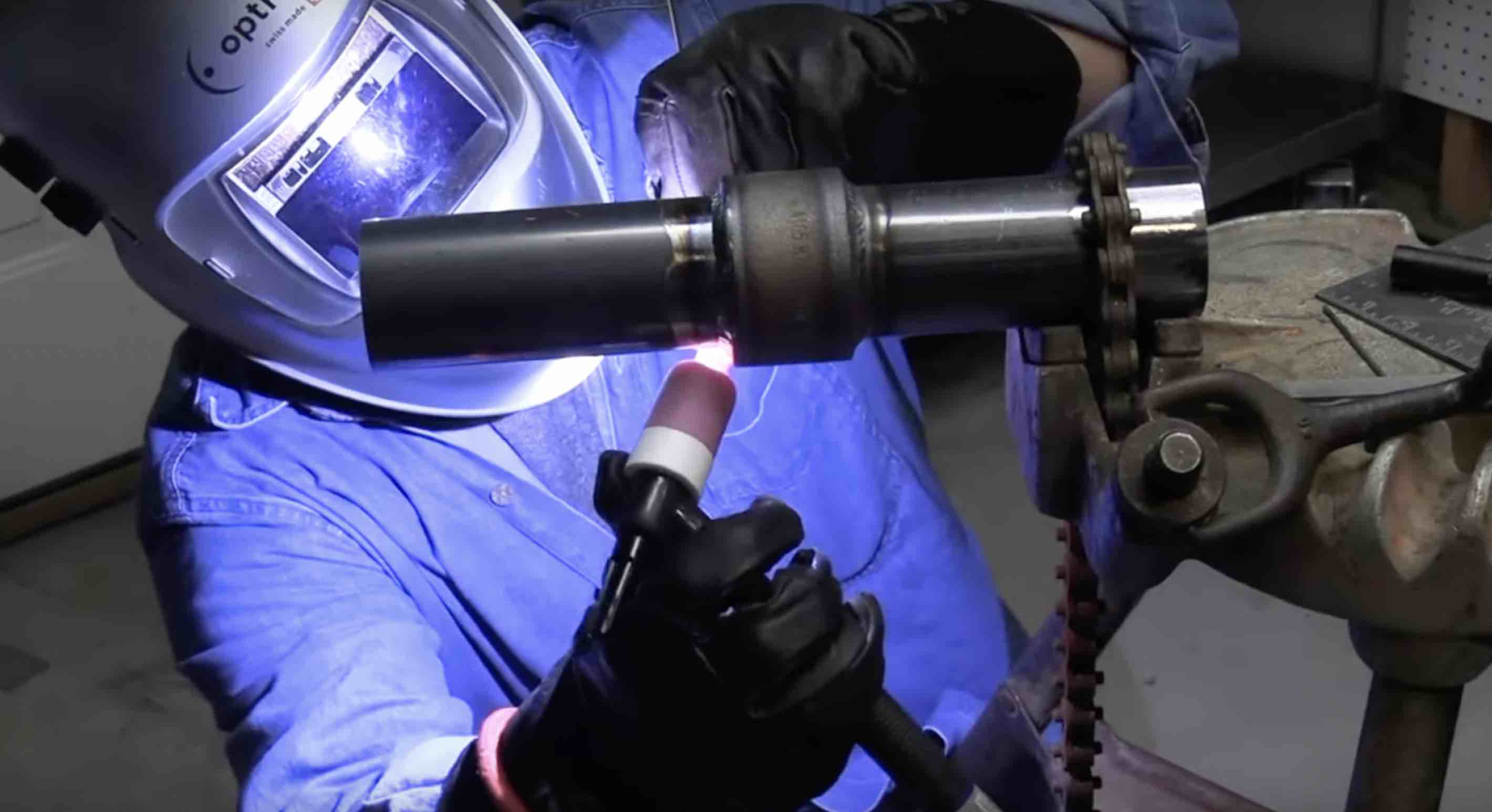

There are no hard fast rules on how to hold a tig torch.
But the videos on this page will give you some suggestions on how to hold a tig torch for different situations.
how-hold-tig-torch-beginners

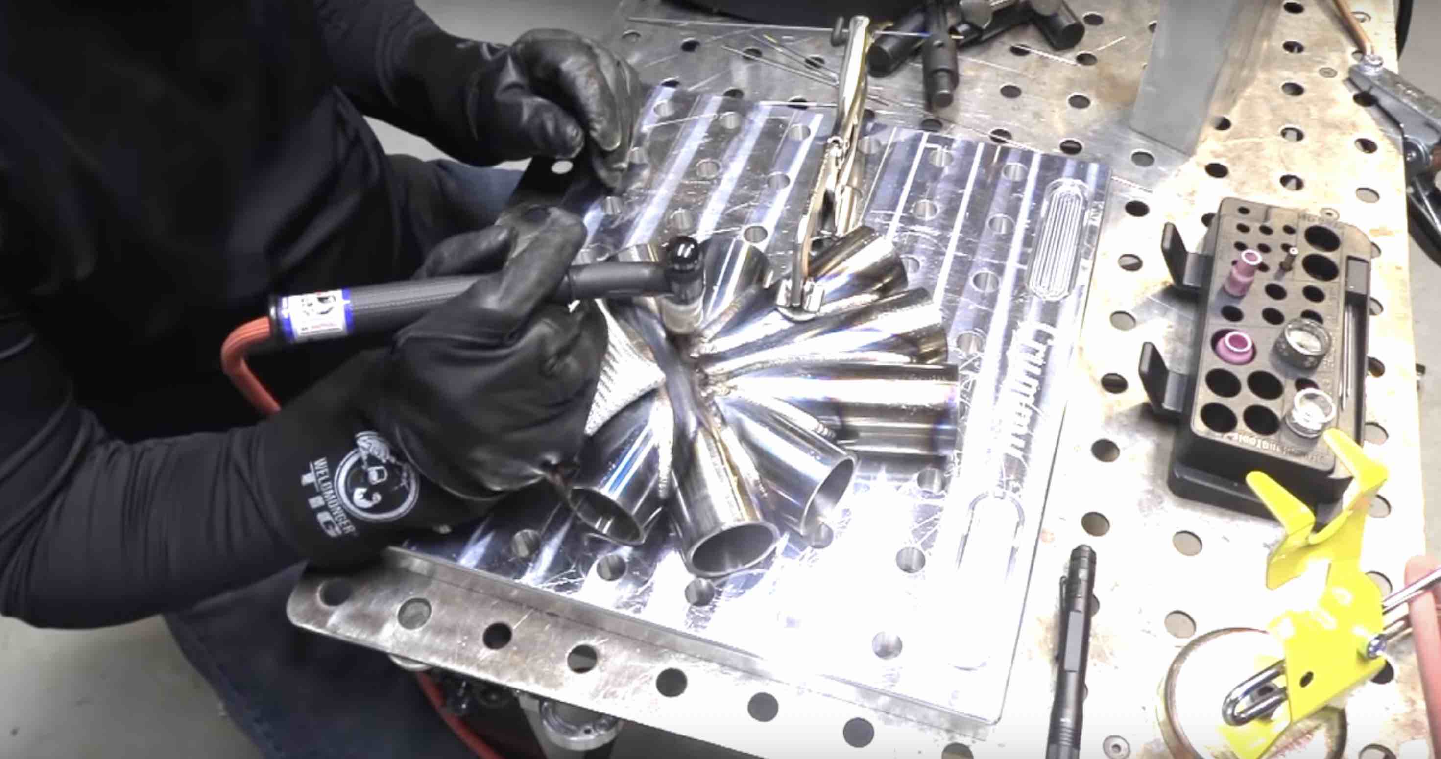

There are so many different scenarios welders get into that require holding the tig torch in different ways.
When welding on a workbench, I usually hold the tig torch like it was a big fat sharpie pen.
But when I am welding up over my head on a chromoly cluster joint, I might hold the tig torch differently.
