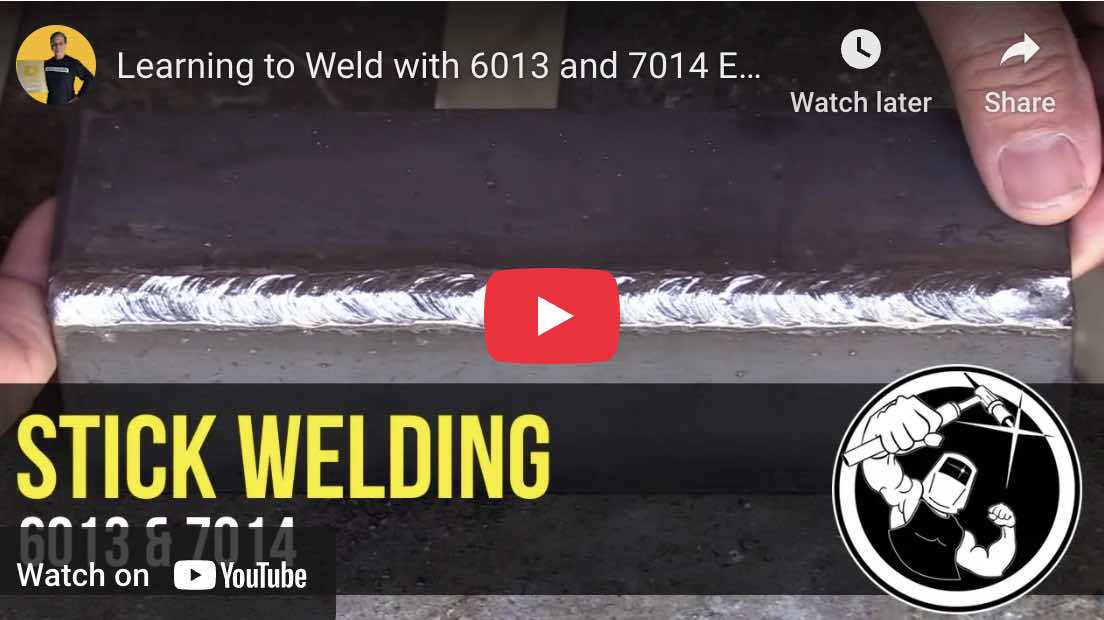

Learn Basic Stick Welding Starting with 6013 with Bonus Tips on "How Not to Weld"
stick-welding-6013-7014
6013 electrodes restart easily and will work with any polarity.
AC, DCEP, DCEN.  All work very well.
Same goes for 7014.
6013 and 7014 are very similar but 7014 has a much heavier flux coating and lays down and fatter bead.

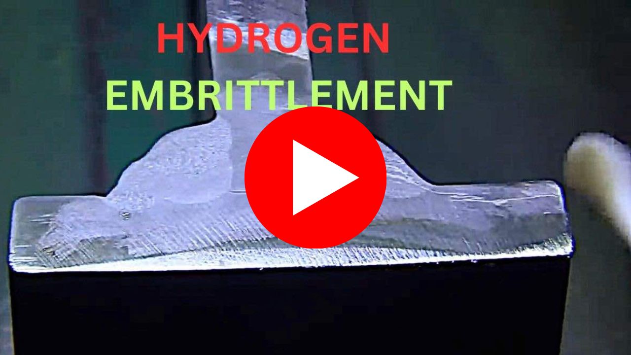

Why Low Hydrogen? and What is hydrogen embrittlement?
hydrogen-embrittlement-thumb
Hydrogen embrittlement from welding happens when hydrogen atoms enter the metal during or after welding, making the metal more likely to crack. This is why low hydrogen electrodes are often specified for structural welds.
7018 is one of the most commonly used low hydrogen electrodes but low hydrogen rods are no longer low hydrogen if left out in the atmosphere too long.
