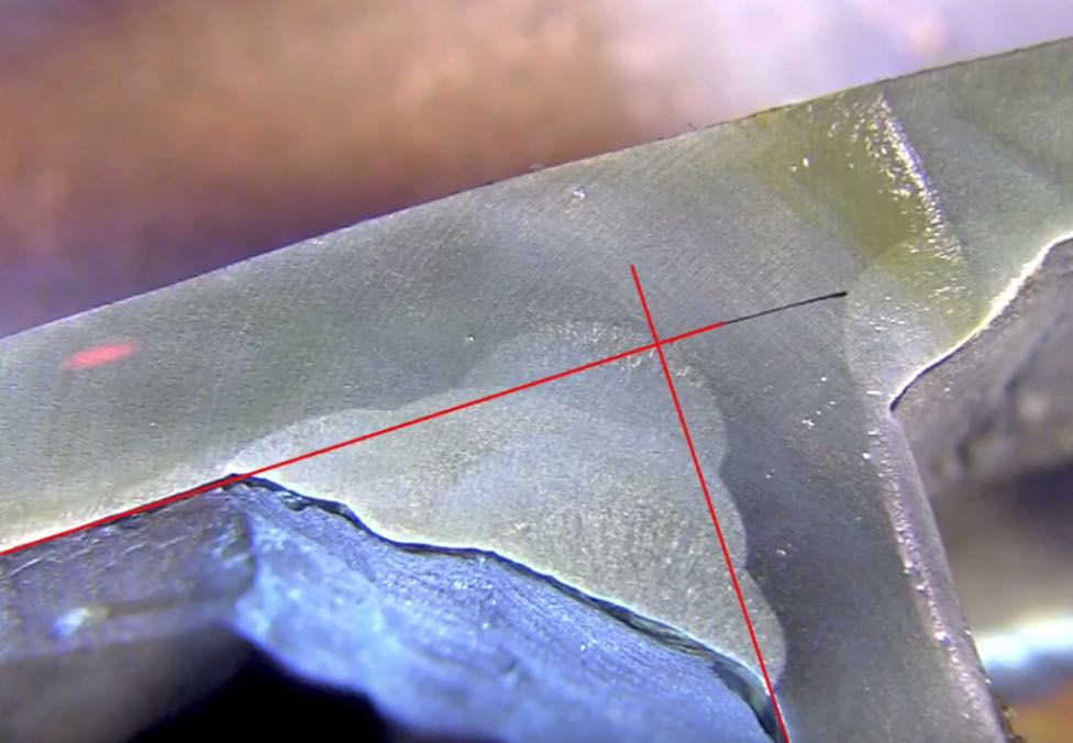

7014 cut etch multipass

  3. Causes Cracking: Over time, the trapped hydrogen weakens the metal, especially in high-stress areas. This can cause delayed cracking (sometimes called "cold cracking"), which may not appear immediately but develops hours or days after welding.
What Are the main problems with hydrogen embrittlement from welding?
  • Brittleness: The metal becomes less flexible and more prone to breaking.
  • Cracks: Small cracks may form in the weld or heat-affected zone (HAZ), reducing the overall strength of the joint.
  • Failure: In extreme cases, hydrogen embrittlement can lead to complete failure of the weld, especially in critical applications like pressure vessels, pipelines, or structural components.
