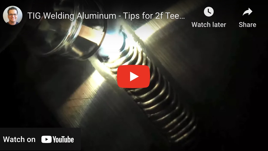

How to TIG Weld Aluminum Tee joints
2f tee aluminum yt thumb
How to tig weld aluminum -  a thin .063" tee joint fillet weld

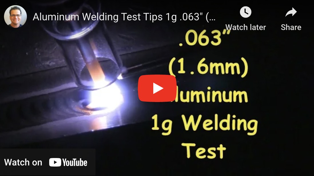

Tig welding .063" (1.6mm) aluminum 1G butt
