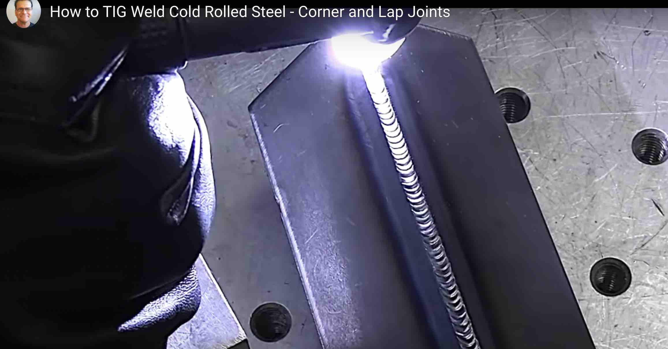

This page is about how to tig weld cold rolled steel corner joints and lap joints.
Cold rolled steel has a cleaner finish than hot rolled steel and does not have a thick layer of mill scale like hot rolled steel.
Cold rolled is usually clean enough that it can be tig welded without cleaning or prep work.
But it will weld even better if you take the time to clean it.
A flap disc followed by a wipe down with acetone usually works just fine.
I like to use a gas lens for tig welding cold rolled steel as well as most other metals...and I used a jazzy 10 clear cup (helps with filming) and a furick 12 ceramic cup for the lap joints.

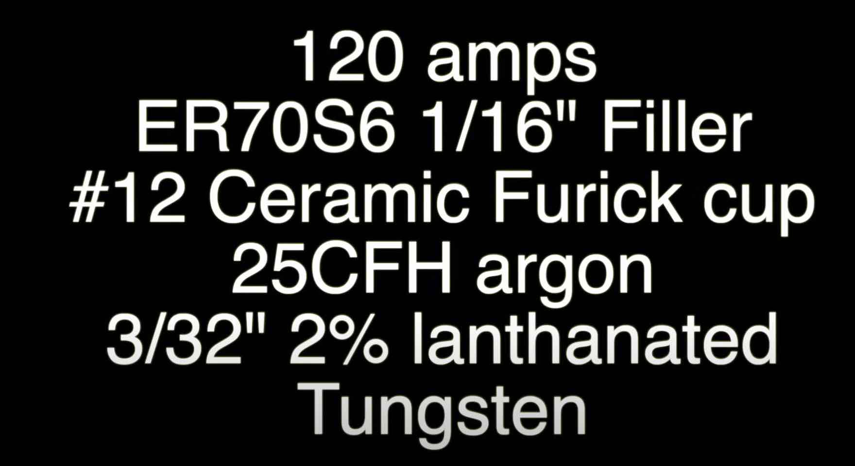

corner joint settings for 11ga cold rolled steel
11ga-cold-rolled-corner-1f
cold-rolled-11ga-corner-settings

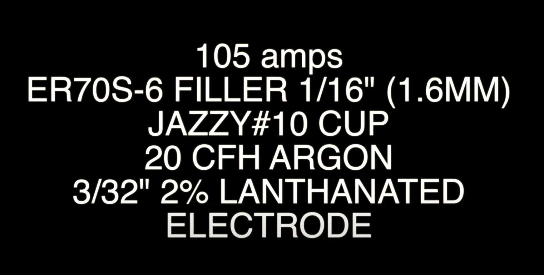

lap joint settings for 11ga cold rolled
11ga-cold-rolled-lap-joint-tig
cold-rolled-steel-lap-11ga-settings
