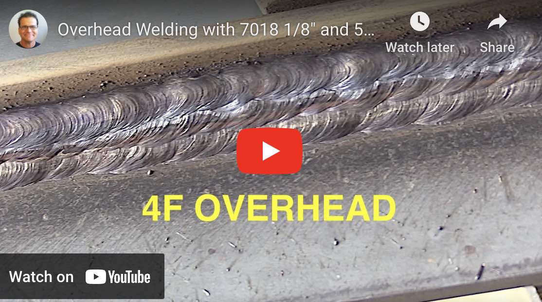

A rooftop overhead tee joint resembles the bottom portion of a pipe joint and helps prepare a student for pipe welding in the 5g position
overhead-4f-7018-multipass-thumb
here is my best advice for overhead stick welding with 7018:
"Set the amperage within the recommended range for the diameter of electrode used but set amperage high enough that the rod wont stick when holding a tight arc..then make sure to hold a tight arc."
4f-overhead-7018-8th-yt-thumb
