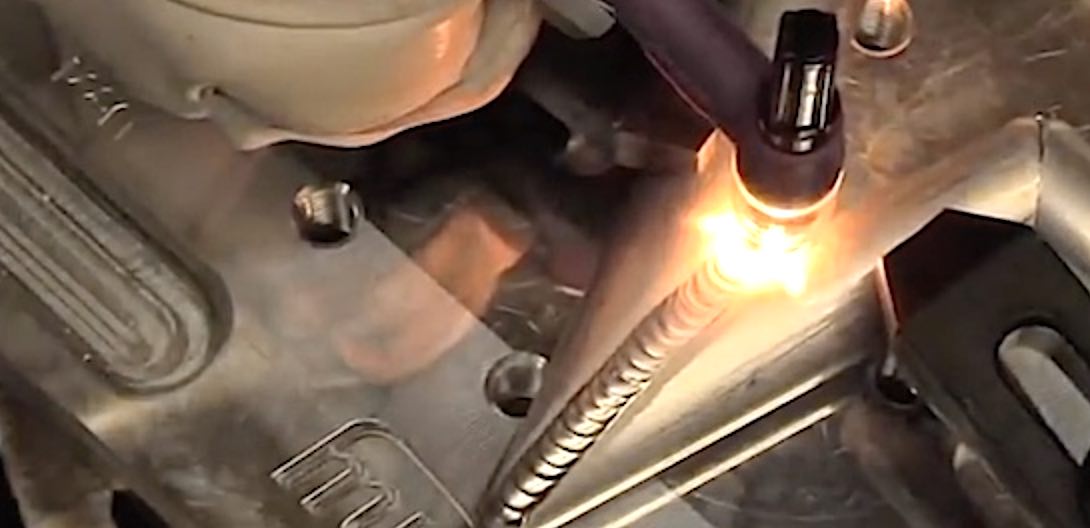

Understanding Aluminum Before Striking an Arc
Aluminum welds differently from steel for one key reason: it forms a hard oxide layer that melts at triple the temperature of the base metal. The moment you clean it, it starts reforming. This oxide acts like a shield that prevents proper fusion unless it is removed during welding.
Why AC TIG Is Essential for Aluminum
tig-aluminum-tube
In DC TIG, heat travels primarily into the workpiece. That’s perfect for steel. But aluminum needs more than heat—it needs oxide cleaning action. That’s where AC TIG comes in. The EP (Electrode Positive) portion breaks up the oxide, while EN (Electrode Negative) delivers heat into the metal.
Dialing in AC Balance aka Cleaning Action
aluminum-tig-welding-balance-10
  • More Cleaning (+EP) = More oxide removal, wider etch zone, hotter tungsten.
  • More Penetration (+EN) = Narrower etch zone, deeper weld, cleaner tungsten tip.
The goal is to set enough cleaning to maintain a shiny puddle without overheating your tungsten.

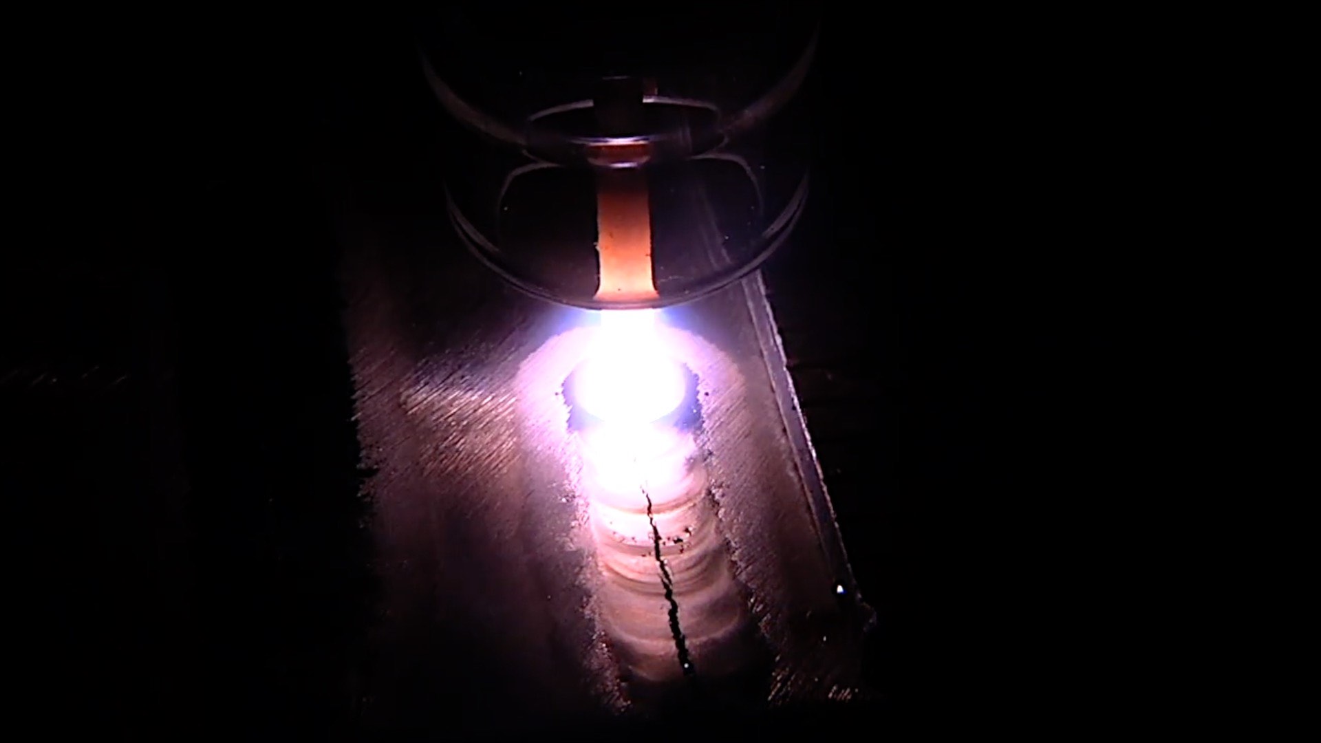

Hot Shortness – Why Fusion Welding Aluminum Cracks
hot-shortness-crack-aluminum
Unlike steel, aluminum has almost no plastic range. It transitions from solid to liquid instantly. When it cools, internal stress has nowhere to go—so cracks appear. That’s why adding filler metal is not optional on most aluminum joints.
