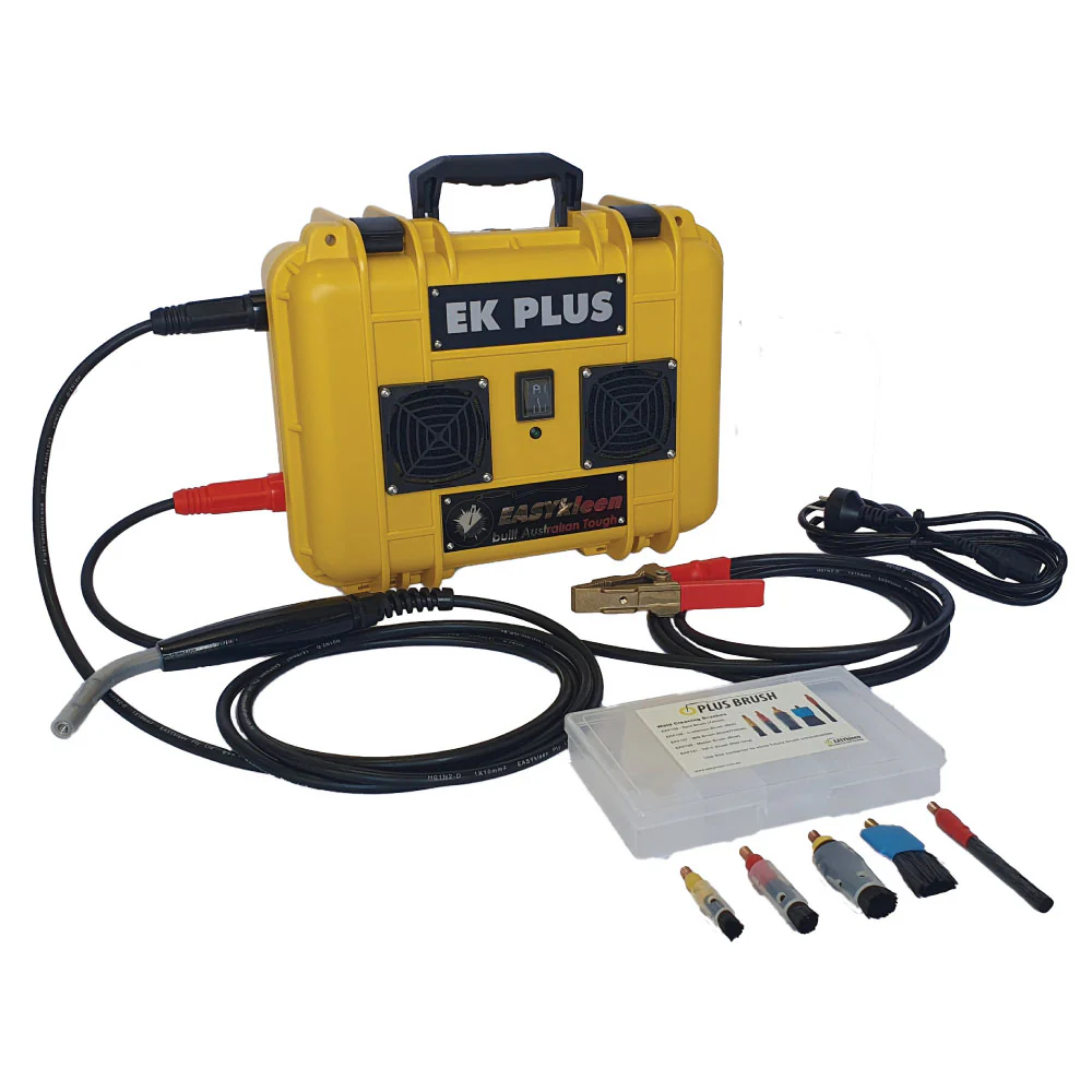

Step 2: Electrochemical Cleaning
Weld Cleaning Machines (e.g., Surfox, Easykleen)
  • Use a conductive wand with a proprietary electrolyte solution
  • Neutralize afterward with water or a post-treatment fluid
  • Fast, effective, and ideal for field or shop use
Benefits:
  • Minimal surface abrasion
  • Consistent, professional finish
  • Safer than pickling pastes in many cases
