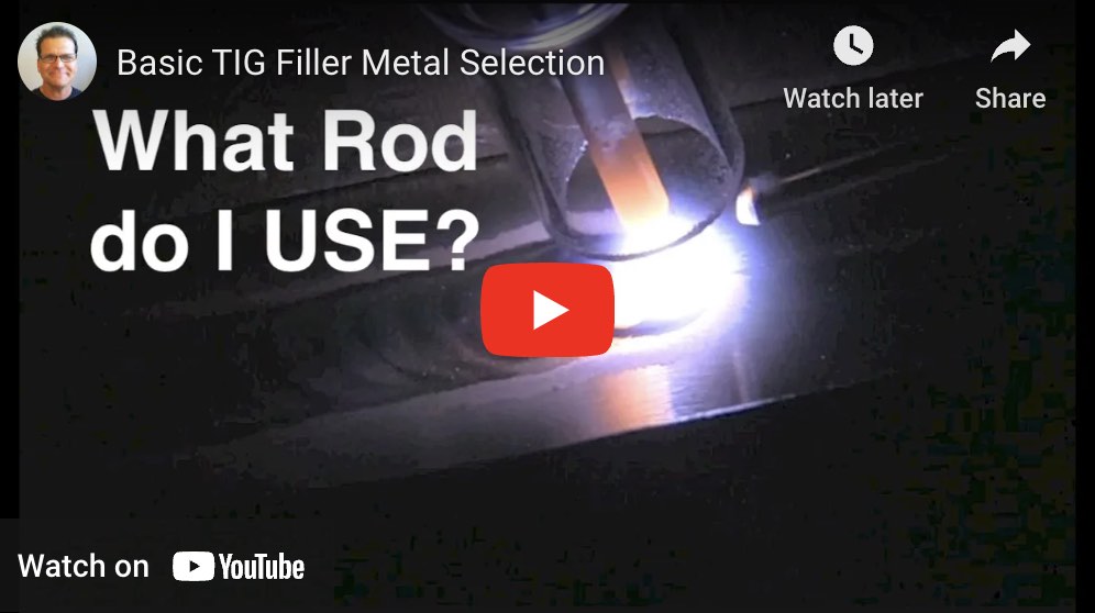

Use the right filler rod
basic-tig-filler-selection-thumb
TIG welding filler metal is in stock at Weldmonger.com
Usually, a matching filler rod is the best choice for tig welding stainless steels.
a good example of this would be tig welding 316L stainless where 316L filler rod would be the choice.
But there are a few exceptions.
For example 304 stainless is typically welded using ER308L filler rod.
Another example is 303 stainless...which is a free machining grade of stainless that contains sulfur to assist in machining. 303 stainless is not recommended across the board for welding but it can be welded for certain applications and ER308L is a good choice.
here is a link to help you choose the best tig rod for stainless steel

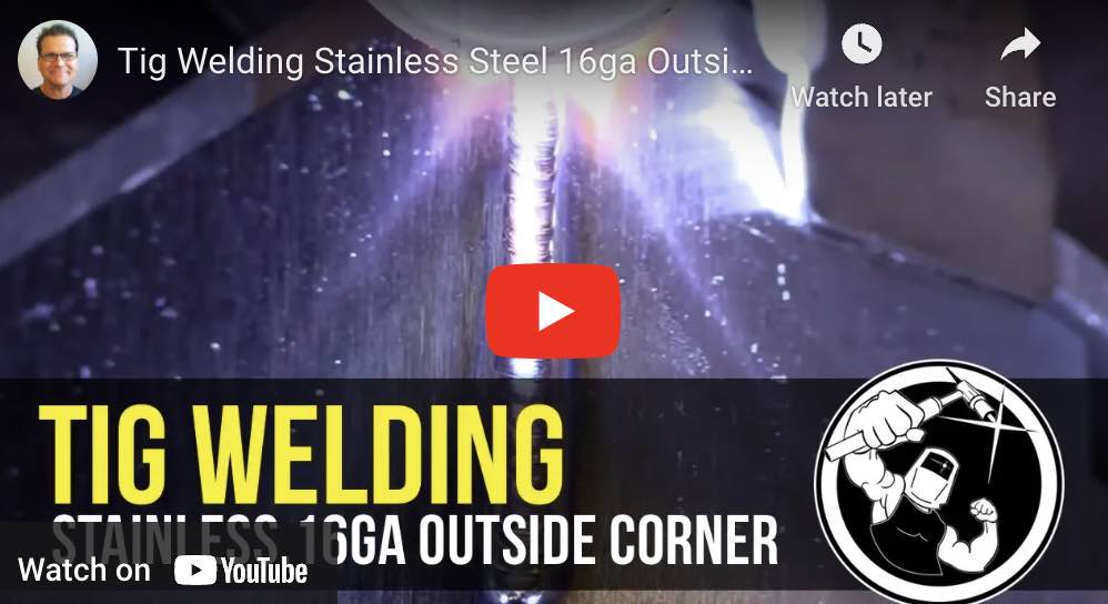

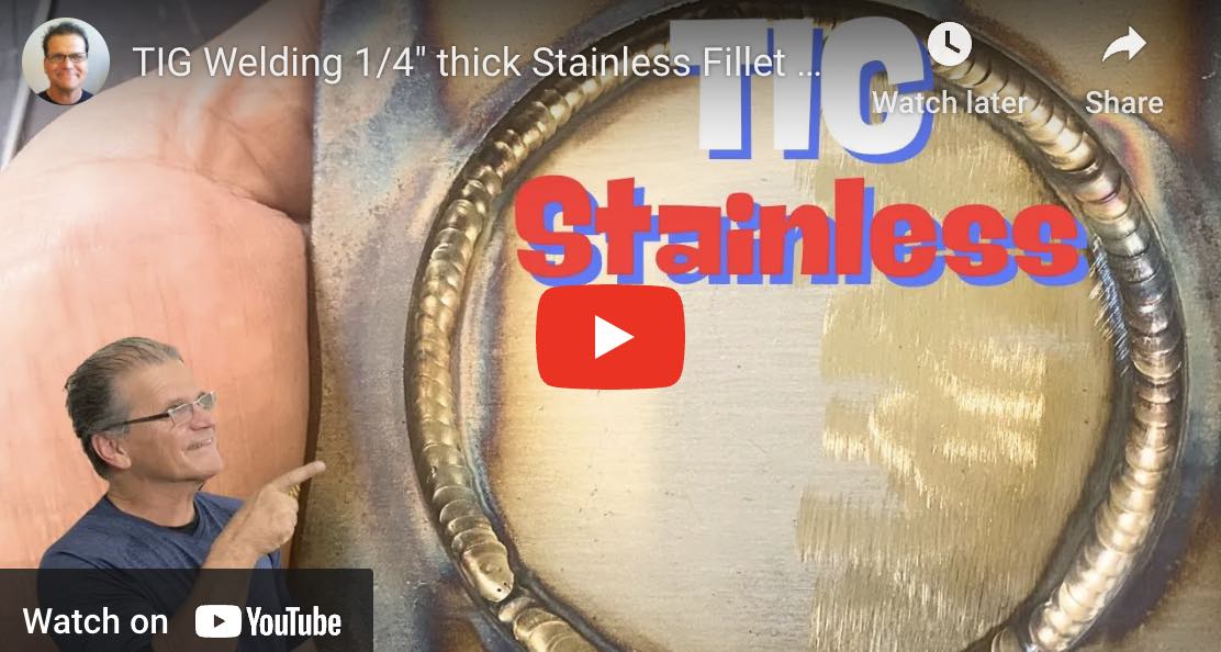

Gas shielding on the front and the back
Gas shielding on the front or welded side is accomplished using the right cup.
But for the back side..the penetration side, either backing or argon shielding is needed for best results.
Argon purge boxes can be made to allow for a purge on the back or penetration side but a copper or aluminum backing can also be effective.
tig-stainless-corner-16ga-thumb
tig-welding-stainless-holes-yt-thumb
