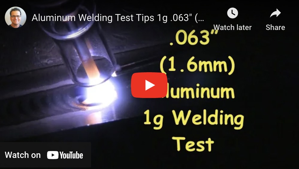

For best results, you need to make sure the metal is clean enough before welding.
But what exactly does "clean enough" mean?
For plasma cut edges, clean enough could mean filing or sanding down the dross on the cut edges.
For brand new aluminum sheet with a peel coat, clean enough could be only a simple wipe down to remove shop dust.
For dirty aluminum that is corroded or been in a bucket along side steel for a long time, clean enough might mean sanding with a flap disc or scotchbrite disc to remove the layer of corrosion or contaminants.
You read in text books that aluminum should be brushed with a stainless wire brush to remove the oxide layer before welding.
But on certain applications, for example, polished or finish machined aluminum products, wire brush marks are not tolerated.
Personally, I think wire brushing brand new aluminum is only really needed for a handful of applications like a full penetration butt weld on sheet or tubing or an aerospace weld test that will be X rayed.
You certainly wont find a manufacturer of polished aluminum tread plate truck boxes wire wheeling the weld area before welding.

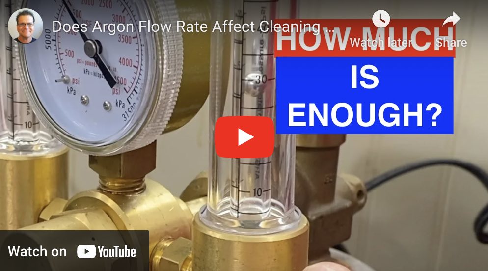

AC balance needs to be set with enough cleaning action to provide a clean shiny puddle.  Gas flow also affects cleaning action
how-much-argon-cleaning-action-thumb
AC balance and argon flow rate are related.
The cleaning action of the AC arc will only go where there is argon coverage.
Not having enough flow rate for a given cup will limit your cleaning action of the arc and you might think you need to adjust your AC balance setting when what you really need to do is adjust argon flow rate.
