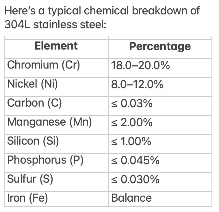

Let’s break down the name “304L.” The number 304 identifies the basic grade, which belongs to the austenitic family. The “L” stands for “low carbon.” This seemingly small difference has a major impact. By reducing the carbon content (typically to a maximum of 0.03%), 304L minimizes the risk of carbide precipitation during welding...at least compared to regular 304 stainless. That means better weldability and less susceptibility to corrosion in the heat-affected zones of welds.
In simpler terms? If you need stainless steel that can be welded without cracking or losing its corrosion resistance, 304L is often a good choice.
Chemical Composition and Structure
chemical-composition-304L-stainleess
You might notice that the chromium is between 18 and 20% and the nickel is between 8 and 12%.
this is why 304L stainless is often referred to as 18-8 stainless steel.
