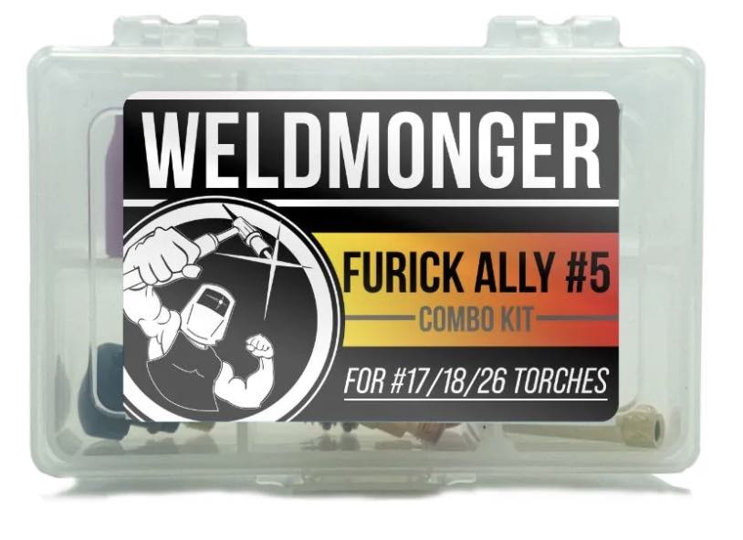

ally 5 combo kit contents
This #5 combo kit  includes a clear #5 as well as a ceramic #5 cup along with collet body and all the parts needed to fit your torch. We have a kit for #9-20 style torches as well as 17, 18, 26 style .
ally 5 combo kit label side
