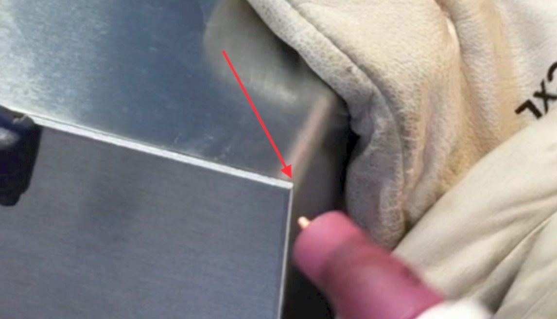

TIG welding aluminum...Tips for Tack welding
Tack welding aluminum without filler metal often ends with cracking.
But if you notice those corner tack welds in the video, the sharp corner of the end caps along with the slight radius in the bend, provide a nice way to tack without filler metal...because the corner becomes the filler metal.
When I am building a project, I almost always work alone.  And so do most welders I know.
So tack welding with one hand without filler metal is necessary.
Most books advise against it.
But books dont weld.
So its helpful to know how to tack weld aluminum without filler metal.
Most of the time, I do it sparingly.  I might get one or 2 tack welds without filler just to hold the part while I get several more tacks using filler rod....even then I will go back and add filler rod to those first tack welds because aluminum tack welds can be very weak.
