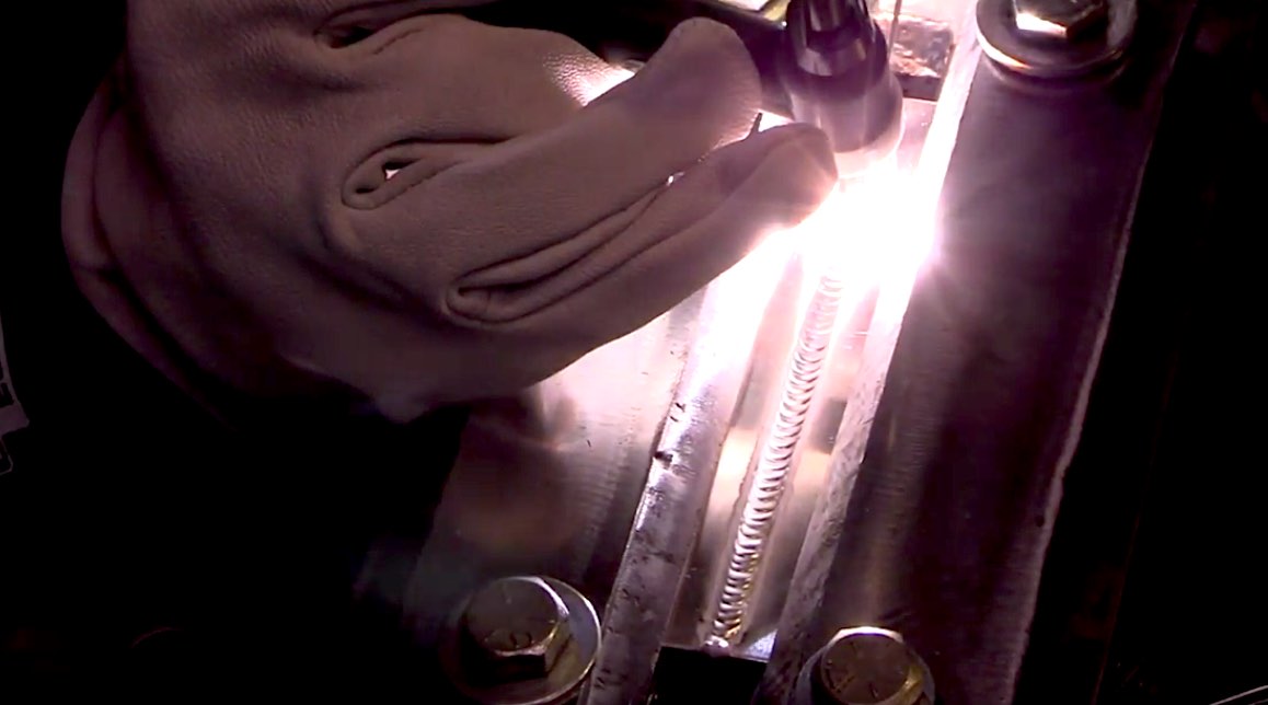

What is the most important thing to do for preparing a 1G aluminum Butt joint test weld...that will be x rayed?
You will see in the video but let me explain it here also.
This video demonstrates the need for cleaning aluminum for test welds and for critical applications or when the weld will be x rayed.
Yes, it will help to wire brush the aluminum to remove oxide.
Yest it will help to wipe with acetone
Wait for it.....
Cleaning the sheared edge of a test piece makes more difference than any other single thing.
The sheared edge of a piece of aluminum sheet metal is rough with lots of embedded oxides.
unless you remove those oxides, they can create linear porosity.
Linear porosity is bad.  The limits for linear porosity in code books are much more stringent than scattered porosity.
that is due to the fact that linear porosity is much more likely to form a crack.

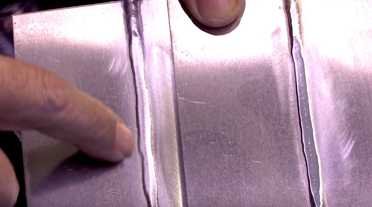

So how do you determine if your cleaning method is up to snuff for x ray without an x ray test.
One way I have learned is to blend off the penetration side of the plate using   scotch brite discs.
I start with a brown one and then use a red one and I have found that will reveal any significant porosity.
you could even take it a step further and use finer polishing wheels to reveal really small porosity.
This is just a down and dirty information test not sanctioned by the AWS ANSI, or ASTM.  Its just a really quick way to get some results to know if your process and procedures on on the right track.
