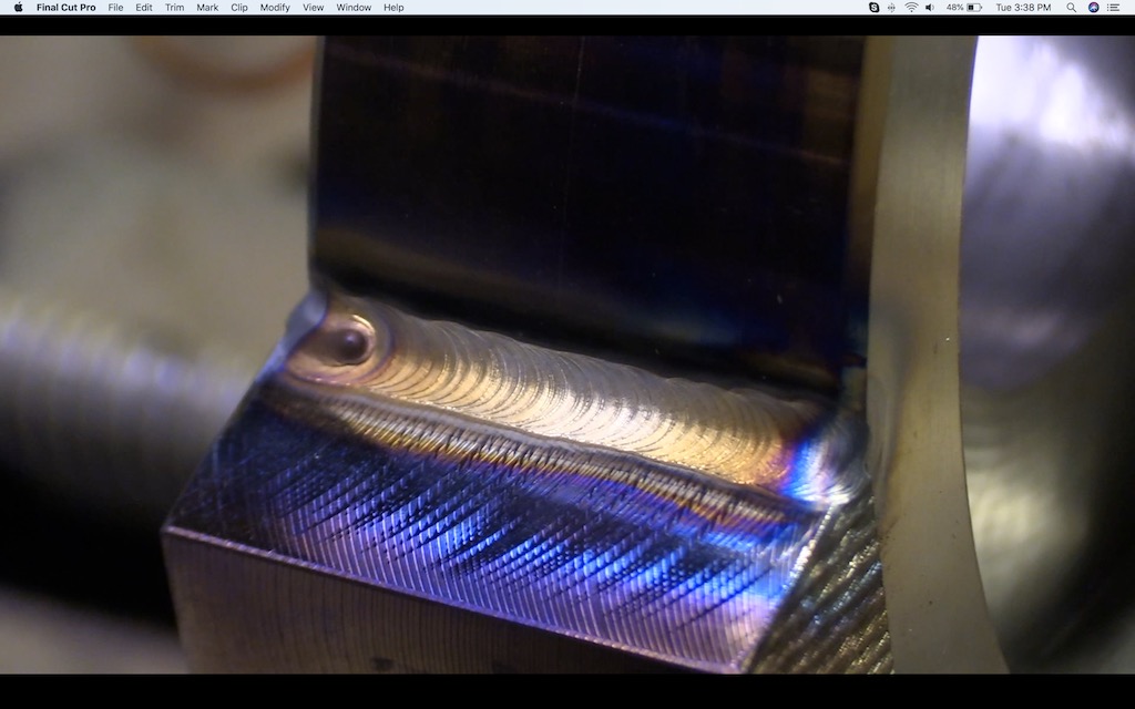

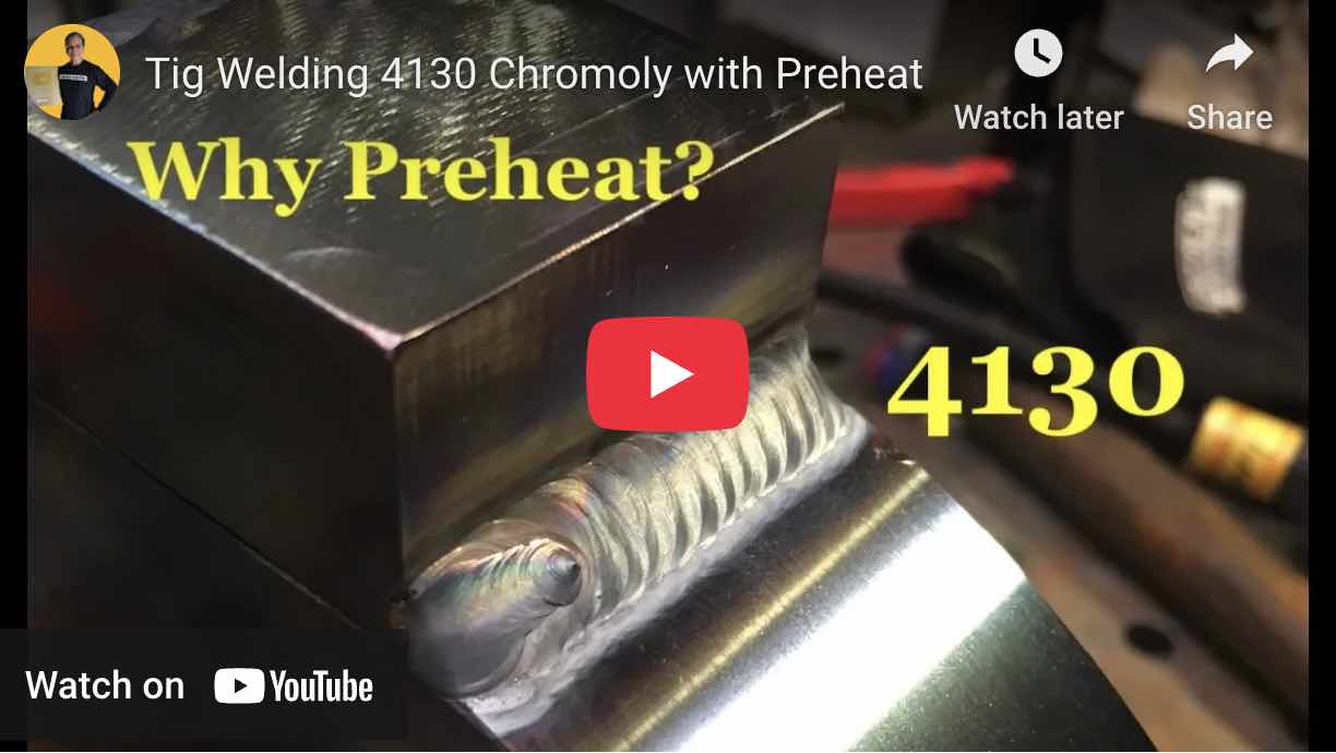

Tips for TIG Welding Thick 4130 with preheat

4130 chromoly thick ceramic 12 root

If you can tig weld low carbon steel like AISI 1010-1020 you can tig weld 4130 chromoly.
But you need to know these subtle but key differences carbon steel and tig welding 4130 chromoly.
Here are the key differences between TIG welding low carbon steel and 4130 chromoly (thickness of .120” and under) that welding students, hobbyists, and professionals should understand:
1. Preheat Requirements
  • Low Carbon Steel (e.g., 1018, 1010-1020, A36, mild steel):
  • No preheat typically required for thicknesses under .25”.
  • Welds are less crack sensitive and more forgiving due to low carbon content.
  • 4130 Chromoly:
  • Preheat may be recommended starting at .120” thickness, usually around 200–300°F, especially for critical applications (like aircraft frames or racing components). Thicker sections require higher preheat.
  • Preheat helps reduce the risk of cracking due to the alloy’s higher hardenability.
