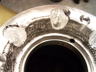

Tip #25...When welding oil soaked aluminum castings like engine blocks, or transmission cases...do cleaning passes with the tig torch...
When welding oil soaked aluminum castings like engine blocks, or transmission cases, clean the surface with acetone, alcohol or similar cleaner.
Route out any cracks with a really coarse carbide burr . (if you done have one try a drill bit)
Carefully heat the area with a oxy-acetylene torch or propane torch to cook out the oil.
Use a 300f temperature stick so you have some gauge to how hot the metal gets. (Its easy to overheat aluminum because it does not change color before it melts.) try to cook out the oil in the weld area without overheating the metal.
Then,…Go over the crack with the TIG torch with low amperage, barely puddle every now and then to see what it looks like. If it is shiny, that’s good. If it looks fuzzy, its still crapped up. Use as small a tungsten electrode as you can and still puddle the aluminum.
These are called cleaning passes. Do not add welding rod. Every time you go over the area it should get cleaner. You will see black discolored or fuzzy looking aluminum in the beginning.
Weld; grind; weld; grind, wire brush, lather rinse repeat.
Eventually the aluminum will be shiny silver color, then you can weld with filler rod and larger tungsten.
