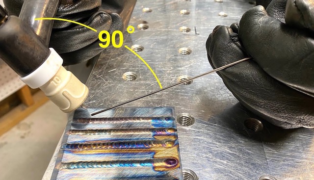

Tig Welding tips... #1. Learn to feed the filler rod by doing it while you watch TV.
Go here for How to Feed the Tig Rod
When you are learning to tig weld or just trying to be a better tig welder, The last thing to come up to speed is the hand that feeds the rod. We all learned how to hold a big crayon in kindergarten and holding a big crayon is not too different from holding a tig torch….so we’ve got that going for us.
But the other hand? the hand that feeds the filler rod... It’s a bit of a slow learner.
A good TIG glove helps. If you have problems feeling the wire with a glove, Try some really soft and thin tig gloves like Tillman goat skin tig gloves or even some woven cotton gloves... Whatever it takes.
FYI...The problem with mechanics gloves is that you cant get them off quick enough if your hand heats up.

Tig Welding tips... 3. TIG Torch angle should only be around 10 degrees or less
Ideally, torch angle should only be around 15 degrees or less. Too much torch angle will deflect the heat and melt the rod before you ever get it into the puddle. This causes the rod to ball up and blob into the puddle. That’s bad. You don’t want that. You want to slip the filler rod into the puddle so that you can get a consistent bead. There are exceptions to this…like when you are using a lay wire technique and leaning the torch back while you walk the cup. But if you are dipping the rod in the puddle, too much torch angle usually is not a good thing.
But good news, torch angle can be very forgiving as long as your arc length is tight enough.  (arc length should be less than diameter of electrode used)
Lay wire technique using a lot of torch angle

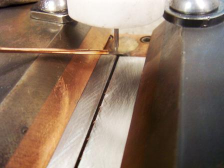

Tig Welding tips... #4. If a ball forms on the end of your rod when welding you are doing something wrong.
It is usually one or more of these things:
• Too long an arc… • Too much torch angle • Not enough amperage for the rod size • Bad filler rod angle • Or some combination of all of these things.
The 2 things I see most often with new learners are too long an arc AND too much torch angle. A long arc sets TIG welding back a few decades because it’s more like gas welding with an oxyfuel torch. The heat is not concentrated and you get this big heated arc plume like you get with a gas welding torch.
Why would you want that?
Your arc length should not be much more than the diameter of your tungsten electrode. I know that’s pretty close and if you get too close you will be grinding electrodes more than you are welding. But if you want really good welds, you need to use a tight arc. Torch angle is the other thing…we already covered it in TIG welding tip #2.
