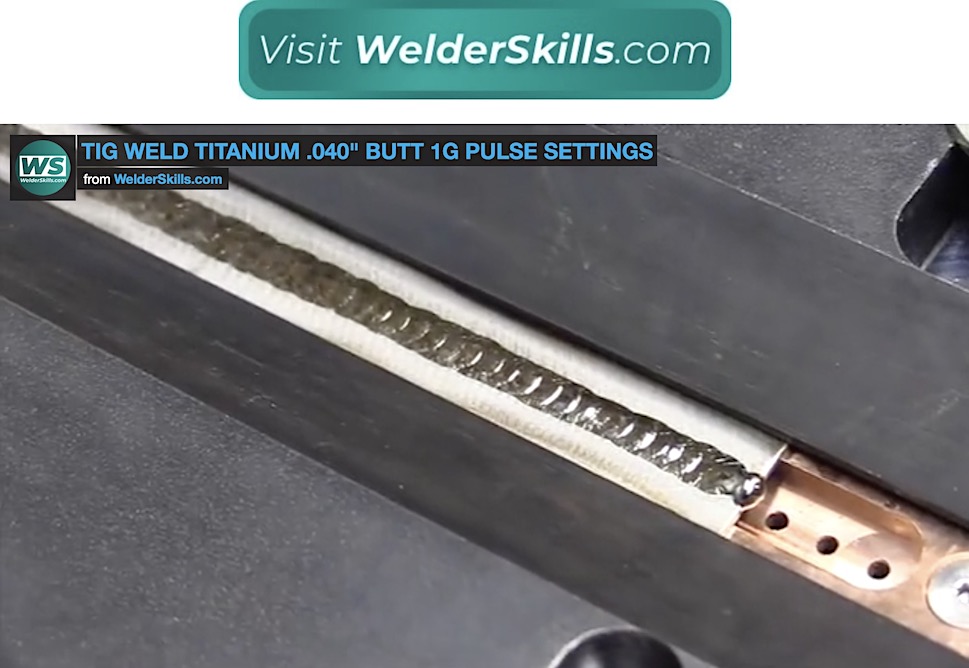

TIG WELD TITANIUM .040" BUTT 1G PULSE SETTINGS
scroll down for settings
primeweld 225 tig with stuff
challenger kit 17 front
challenger kit 17 contents
METAL TYPE = TITANIUM 6AL4V
THICKNESS = .040”
WELD TYPE = GROOVE WELD
JOINT TYPE = BUTT
POSITION = 1G FLAT
AMPERAGE = MACHINE SET TO 100 AMPS USING PULSE SETTINGS AND FOOT PEDAL
FILLER WIRE = .045” CP TI
POLARITY =DCEN
GAS FLOW = 30 CFH argon
CUP SIZE =  16
ADDITIONAL SETTINGS =   PULSE SETTINGS : 100PPS, 25% BACKGROUND, 40% PULSE TIME
PRE FLOW = 1 SEC
POST FLOW = 11 SEC
TIPS: KEEP A FAIRLY TIGHT ARC AND WATCH TORCH ANGLE
Aim for an arc length that is equal or less than the diameter of your tungsten electrode.
Torch angle can be forgiving provided your arc length is tight.
