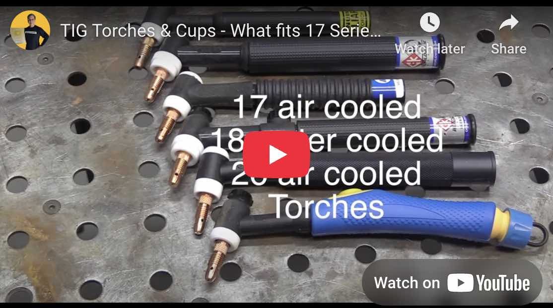

The most popular style torch is probably a #17 .. its an air cooled torch rated at 150 amps.
click image below to see the whole lineup of CK tig torches
What is up with the numbering system of tig torches?
A small air cooled tig torch rated for 125 amps is called a #9 style.
The same size torch in a water cooled model is a #20 style torch and its usually good for 250 amps.
The same size torch in a water cooled model is a #18 and its usually rated around 350 amps.
All this make any sense to anyone?  or am I missing something?
