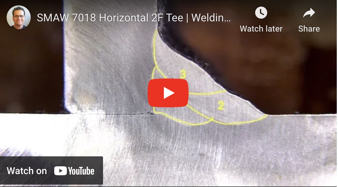

2F multipass tee joint fillet weld
7018-weld-rod-2f-yt-thumb
a 2f multi pass tee joint fillet weld is one of the first few welds you will do in welding school after padding beads.
The skills learned in padding beads and stacking beads evenly will help you with a multipass weld of any kind.
One of the keys to a three bead fillet weld is to place that second bead 2/3 over the first bead...in other words instead of overlapping halfway like you do when padding beads, you need to overlap by at least 2/3 in order to prevent valleys or an uneven leg fillet weld.

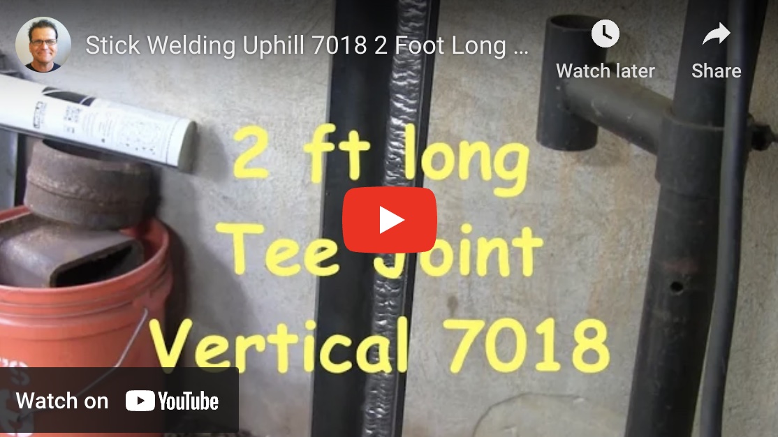

3f tee joint vertical uphill with 7018 1/8" using an old Miller thunderbolt
2ft-long-3f-7018-yt-thumb
You might want to do some padding beads in the vertical position before jumping on a 3f tee joint.
Some procedures call for stringers instead of weaving so practice both tehcniques.

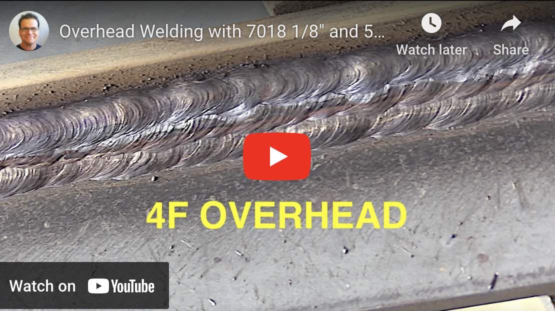

4f overhead tee  using both 1/8" and 5/32" 7018 weld rods
4f-tee-7018-yt-thumb
Overhead is challenging at first but once you understand how to maintain rod angle and arc length, it becomes much easier.

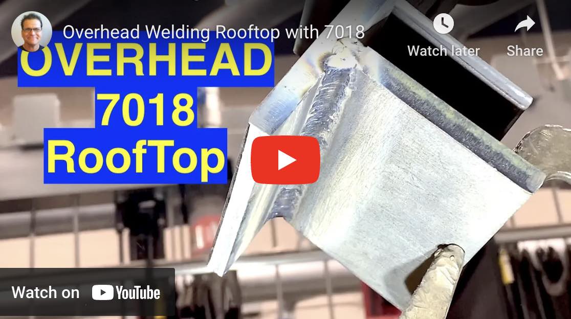

Some people say this is true overhead. We called it a rooftop position when I was in welding school.
7018-rooftop-overhead-video-ytthumb
Rooftop tee joints simulate the bottom of a pipe joint better than a 4f tee joint so a rooftop practice tee joint is a good way to practice your overhead skills before you start welding pipe

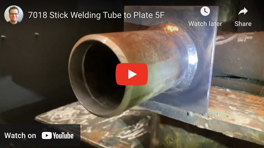

5f test is a tube to plate weld test where the tube is horizontal and plate is vertical.  This video shows a simple 5f fillet weld test using 7018 3/32"
7018-5f-332-ytthumb
even though a 6g test is a more common welding test to get hired, sometimes a certain fillet weld qualification is needed for a specific weld that might be out of the norm.
A 5f fillet weld test qualifies all positions fillet welds on both plate and pipe so is sometimes used for a more limited qualification because its a quick test.
