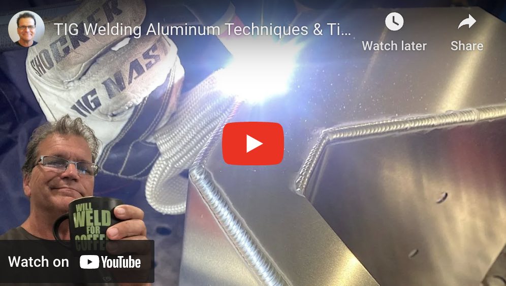

Pumping the foot Pedal technique for tig welding aluminum
Pulsing with the pedal is not necessarily a better TIG welding technique ….it’s just another tool on the toolbelt to achieve a certain result.
Brad owns Goodman Metal Products in Wesson Mississippi.
Brad makes aluminum dog boxes, dog feeders, and also does quite a bit of work for motorsports customers.
Either way, Brads customers want that  "stack of dimes" look.
This video of Brad putting together one of his dog feeders shows how Brad gets a fairly large bead along with full penetration on outside corner joints by pulsing with the pedal.
The material is 5052 aluminum  .090” thick.
Brad set the amperage to around 180 amps because whenever you are pulsing…whether with the pedal or using pulse settings on the machine, you need more amperage for the peak portion than you do when welding with a constant even amperage.
You might notice in the video that Brad is not backing off the foot pedal a whole lot on the low amp side.
I would estimate, that if pulse settings were used, a background current of 60-70% would closely resemble what Brad does with the foot pedal amperage control.
The benefit of pulsing manually instead of with pulse settings is the adjustments you can make on the fly.
When Brad welds around corners, he pulses current only when he is ready for it and that gives him more control for the parts he makes like this dog feeder.
